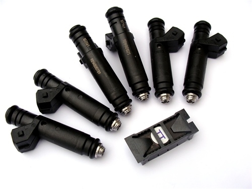

Trying to decide which route to take here I have basic mods plan on adding 42 injectors but have stock for now I’m sure the 255 will work with my setup now but if I go with 340, will it work properly until I upgrade injectors ?
You can get a fuel line kit from racetronix or Cruz. Or you can order your own pieces and make your own. You want a -8 feed and -6 return. What are your goals because you can go quite a ways with a 255
Mid 10s you will likely need to run e85 and a 540 pump or a 340 with a pile of meth. Whats done to the car?
