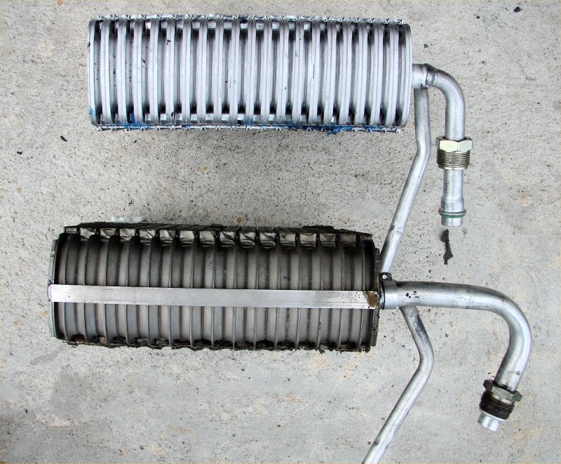

Don't be fooled! Not the correct one to fit our cars. The lower one in this pic is the correct one.
I guess Highway Stars don't have anymore, that's where I got mine a few years ago.
If you buy one definitely get some measurements against your old one.
(Same procedure for the AC evaporator GM# 3056081---after market 6516) This is from Steve Woods Vortex Buicks site as well as the picture I posted. Don't want someone making the mistake of ordering that and not have it fit.

Just thought I would chime in on the evaporator solution. I got one like the one in mark's picture and cut off the tubes and welded my tubes on it. Seems to be working fine.
