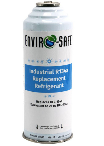

Why not just put this stuff in. Its made to work with all stock R12 components and oil. Sure it has a R134a nozzle on the bottle and you need the R134a adapter and hose to charge it. BUT you only need 2 cans as long as you vacate whats in there and do not use a vacuum on the system. Per their directions. 1 can is equal to 21oz. Total 2 cans 42oz=2.6lbs.
No MSDS on the listing, but they note it's flammable.
It's probably propane. No thanks.
Difloroethane is listed as the main ingredient, but the label says, no CFCs.
I would worry about its compatibility with: hoses, seals, old refrigerant, and oil.
Why not stick with 134a? And it's compatible flushes, and oils?
TIMINATOR
Dust off ,interesting read in Wikipedia I probably would not use it because of it being flammable.
