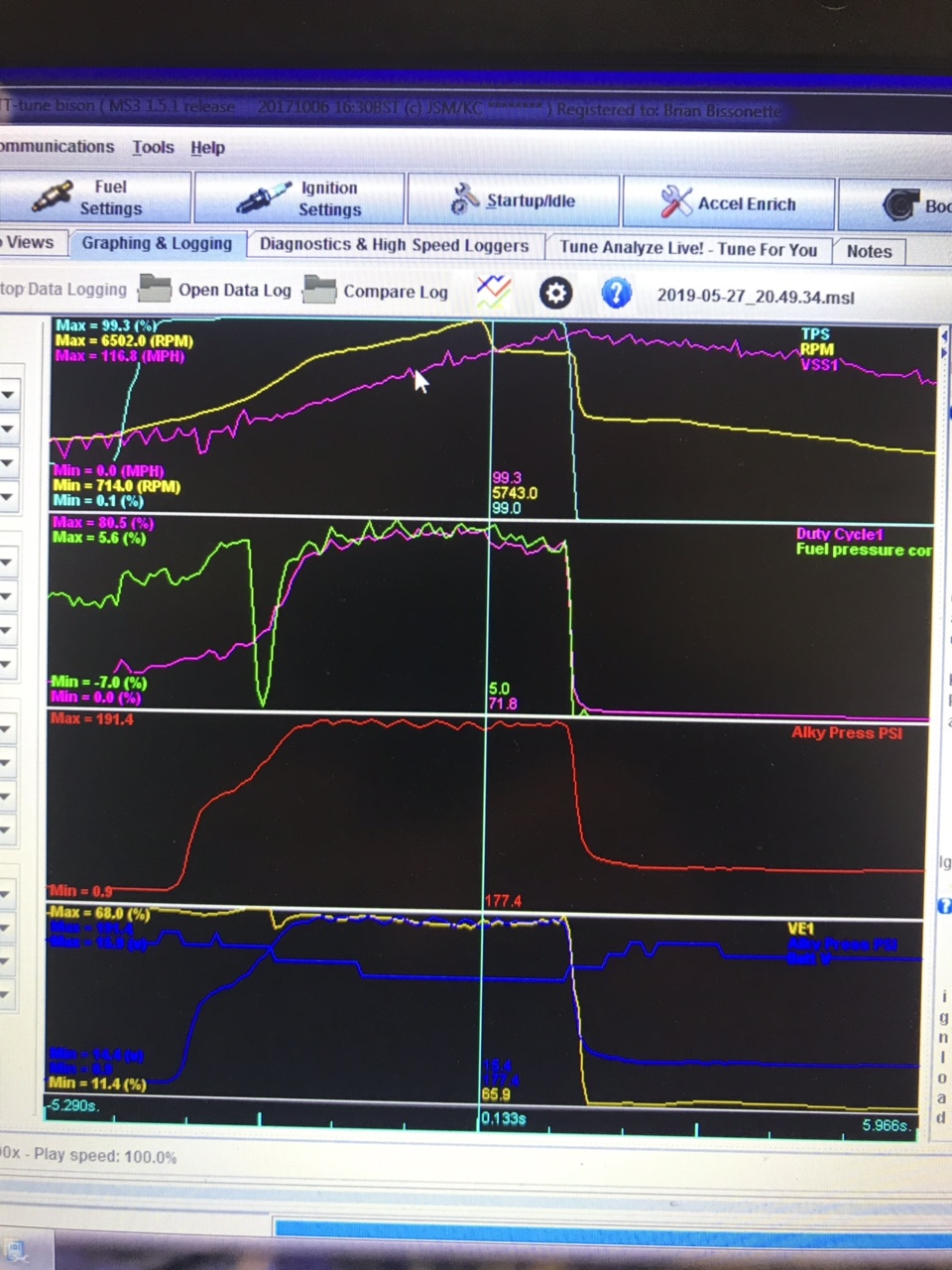

Here’s a WOT 2-3 at about 850hp. I’ve done this approximately 60 times and it’s still the same every time. A little over a tenth of a second. These are the 4L80e Teflon rings dual fed.

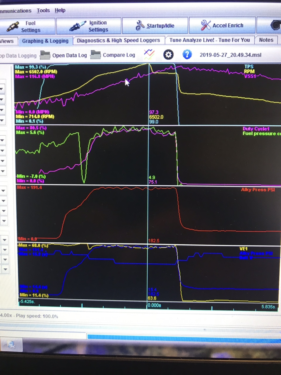

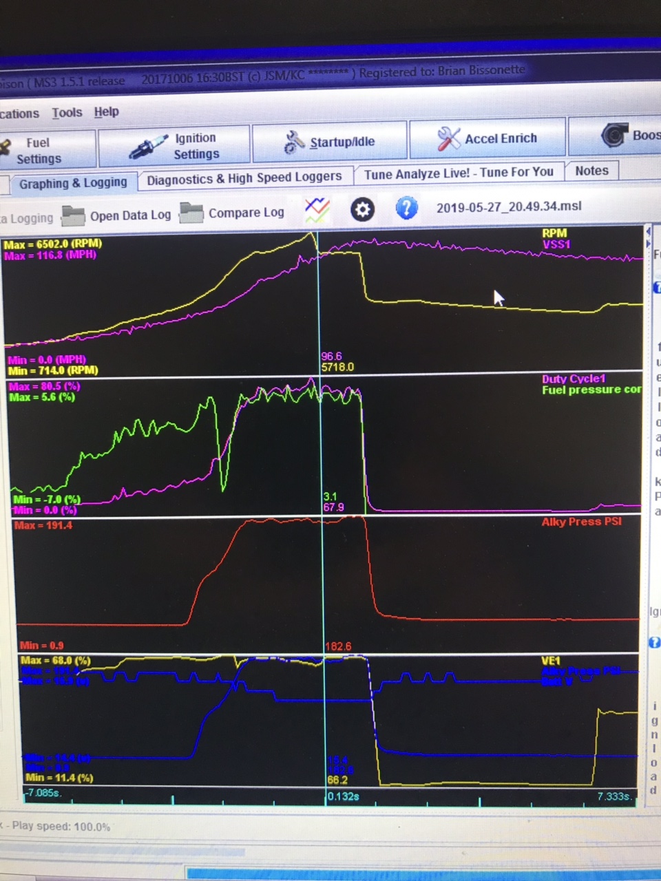

Here’s another before 2-3 and after. About 2 minutes after the last one
