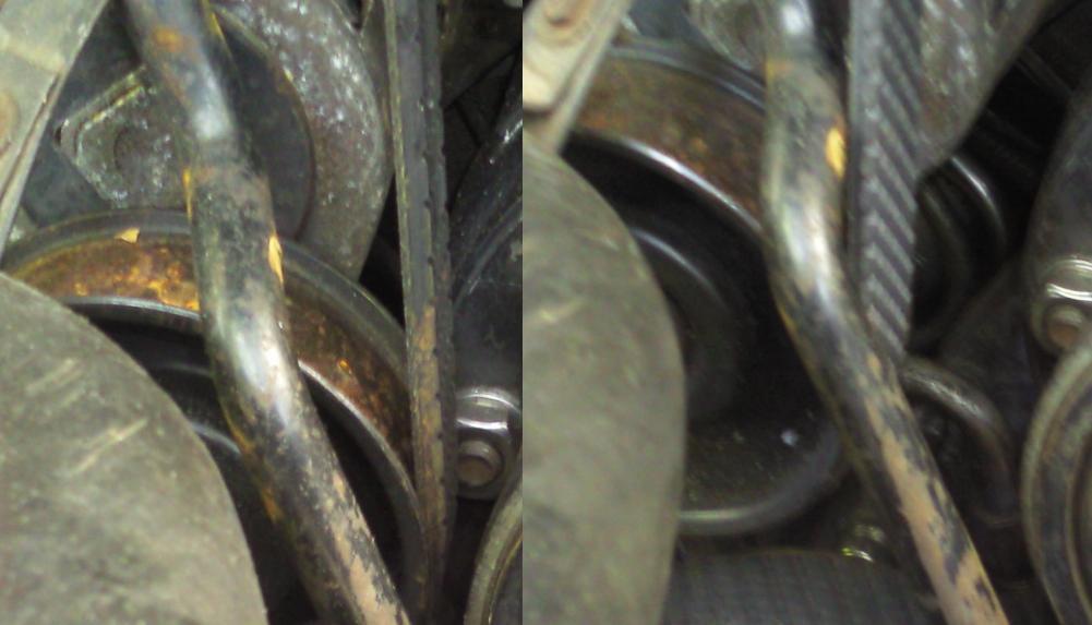

Here's a side by side shot. On the left is acceptable with a tentioner in great shape, on the right is the desired result no matter what shape the tentioner is in.
Notice the intercooler bracket and A/C nut for reference. The snug belt is close to the round bar, and the 'correct' belt has the pulley slightly overlapping the A/C nut.

nice pic earl now let me go check mine
ok my pulley is slightly overlapping ac comp about 3/8" maybe 1/2"
