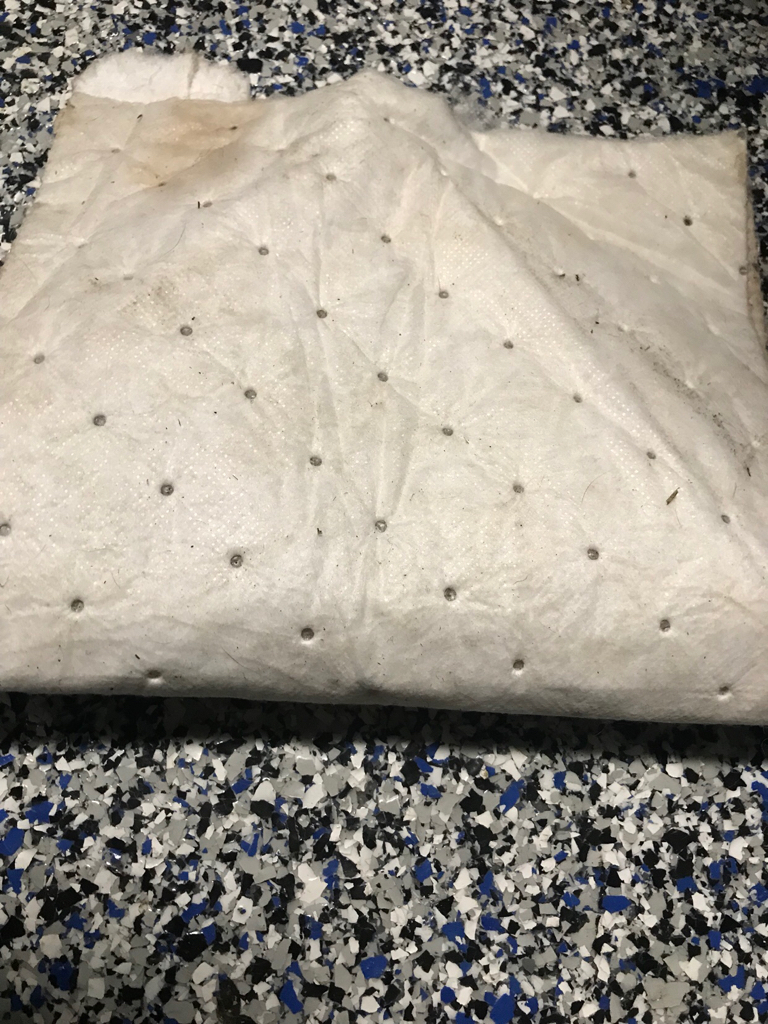

Here is what I am going to use for mine. This stuff works great on oil spills in the garage. Had some major spills before I’d rather not discuss and this stuff worked great.
