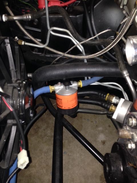

The Pre-Luber hoses were terrible looking so I picked up some brand new PushLok hose to make the install look nice and clean. I also bead-blasted all the brass to bring back its brilliance.
I installed a filter to keep my engine supplied with filtered oil during the Pre-Lubers operation.
I had to re-do the 'T' off of the block because the sending unit for the oil press gauge and the tap in for the Pre-Luber both needed a NPT tapped hole. I plumbed the Pre-Luber in with quick disconnect fittings.
After the install was done I noticed oil pooling from the PTE oil filter location. One of the hoses gave up the ghost. I replaced them both with PushLok hose that matches the Pre-Luber. This hose has a higher pressure and temperature rating. I liked the look of the black hose better and almost used it on the Pre-Luber but after it failed on the Turbo Saver I'm glad I went with the higher rated blue hose.
