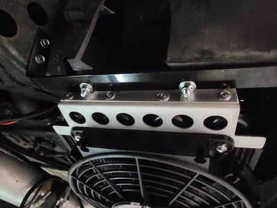

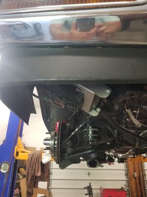

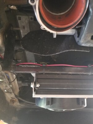

This is where mine was mounted but you obviously cant put it there if you have a stock location intercooler
I had a liquid inercooler on that particular car
It looks low but its really not, pic is on an angle, but some people put it to the left of that under where the would be Alky pump is mounted
Temps would never be over 180 and i actually never witnessed the fan turn on but it didnt matter as long as the temps were in check

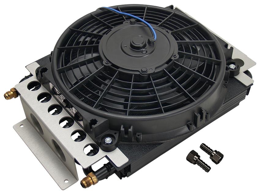

I'm running a Derale 25 row Hyper-Cool rated at 46,000 btu's , mounted under the battery tray on a bracket I made coming off of the bumper mount .
It looks low in the one picture but it is above the air dam .

Ive been running the derale 25 row 46k btu with fan for atleast 10yrs, in series with cooler in rad,have mine mounted up in air dam under drivers side fender, great product,

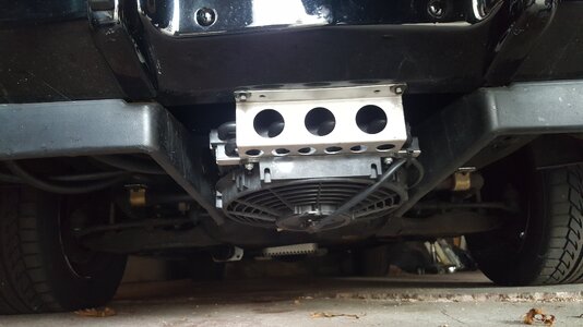

I’ve got this one from B&M been on the car since 2012 have a 9 inch NL up and Trans fluid is still like brand new in 13 years

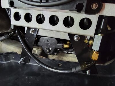

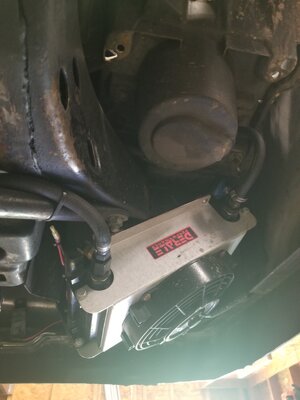

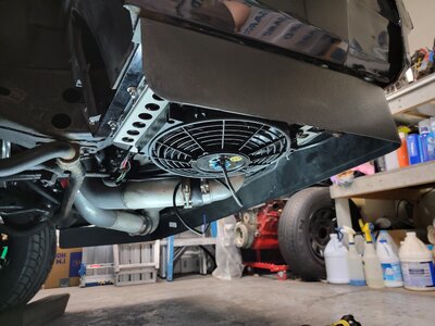

Derale. I made my own brackets.

An-52 and Bigboost, what temps you seeing with that cooler placement, curious?
I have mine setup on a temp sensor, so it comes on at 180° and I belive it shuts off around 165°. Even in the florida heat the trans temps usually stays around 150° +/-. Unless im working it at the track, but the fan really helps pull out the heat. For me it's seemed the best placement, didn't want it under the rear of the car.
