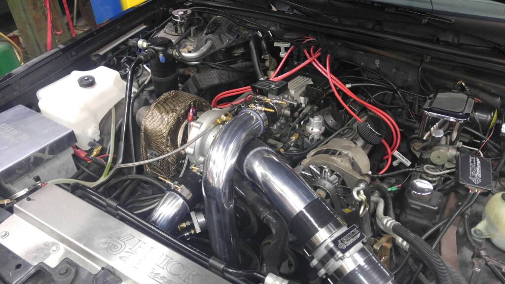

I bought one from Full Throttle speed and I ordered it specifically for the gen2 6266. I dont know that the one they sent will fit and they haven't returned my email I sent a week ago which I know isn't normal for them. I need to call.
My question was if it was the correct one. I really want it to cover that ugly ass factory turbo bracket. I want to make sure it's the right one before I try to stretch it onto the turbo and bracket and get it dirty and then find out it's wrong and they won't exchange it because it's dirty. Just trying to prevent those headaches. The brand is Thermal Zero
Sent from my VS990 using Tapatalk
For you guys that have the blanket, are you running the stock turbo bracket? Does it fit under the blanket?
Looks really nice BTW. How long have you had it?
The DEI LavaRock one got mixed reviews from Amazon. It seems most of them start to shed a little after time.
I got it late last year and my car doesnt get driven in the winter. Its probably only got 300 miles on it. I can tell you i can make a hard pull and lay my hand on it.
