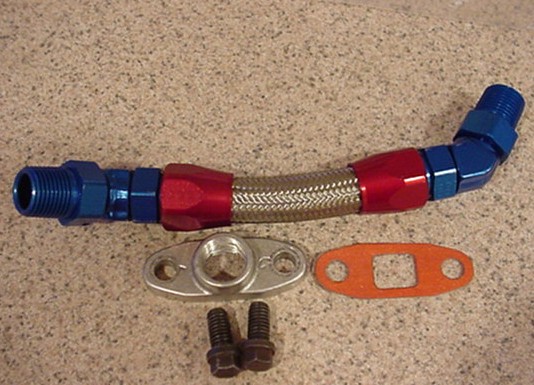

Anyone on here have it? Thoughts? Thanks!
I wouldn't use any of them unless they had at least the same internal cross-section is the stock tube
I can tell you that one in the first picture that bolts to the oil return on the center housing rotating assembly is way too damn small. Don't even need to measure to know it's too small
Gotta agree with Brian here.
If you ever wondered how much oil flows through your turbo feed/drain. Run your oil pump with a priming shaft while the intake manifold is off the engine. You can watch the oil coming out of the oil drain. You would be amazed!!!!
Thanks guys I appreciate the feedback. I wasn't 100% on it and it did seem small... Between that and the fuel rails I had heard more on the fuel rails than this.
