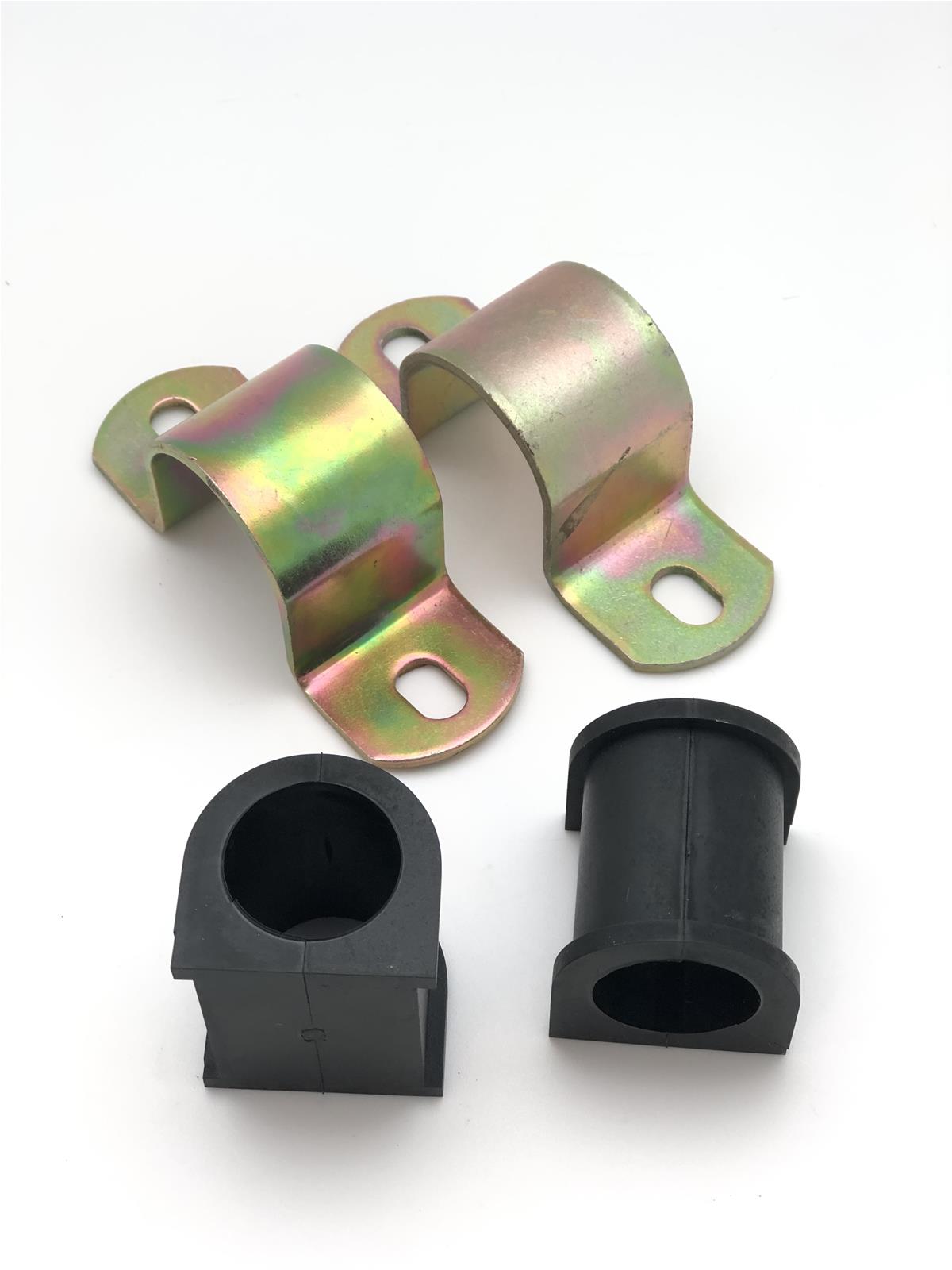

Hello everyone I wanted to know if the Umi front sway bar 1.25 is the same size of the stock sway bar? If they're the same size is the Umi better than the stock one. I don't wanna fork over $ if they are the same and just invest in some new bushings and end links. I do not go to the track I just have a cruiser. Any knowledge would be greatly appreciated.

Stock should be 32mm or 1.259”.
As for the quality difference, can’t answer that one. I have the UMI upfront but I also have their control arms in the front & the rear.
For just a cruiser, I would replace the bushings. Ya can upgrade to poly(more firm=less deflection) if that’s your choice & change the end links if they’re worn out.
I suspect the UMI 1.25” sway bar would be very similar to the stock bar, although if the stock sway bar is made from spring steel and the UMI sway bar is made from chrome moly, the UMI bar might be a little stiffer.
If you’re looking for better handling I feel the UMI 1” solid rear (lower control arm mounted) sway bar would make more of a difference along with poly bushings on the front.
I’ve had less squeaking from Addco brand bushings than any others I’ve tried.
