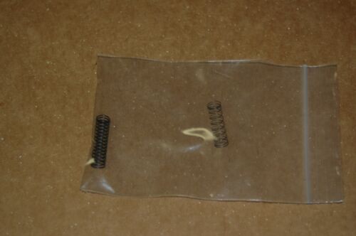

Just went through this. Last month to. GN only had one spring. It's the smaller one. I found mine in the pan. Trans wouldn't shift out of first gear unless you took your foot off the gas. Then it was shift high in every gear. Found the spring in the pan. Removed governor and reused spring as it was still good. Pop riveted it to hold it in there. New filter and fluid. Car never shifted so good. Only place your going to find the correct spring is a guy on ebay. Lee's speed shop. Sells both springs for 58.00 shipped. The tci springs they use to sell had issue from what I've read.

Spoke with the guy on the phone. Said he rebuilds them regularly and he is the only one that has them. Really can't tell if you don't have one to compare. So who knows. The one in the picture looked like my small spring.

He can say what he wants...
There's a very clear difference without measuring anything, GN has 18 working coils, "standard" governors have 14. That doesn't get into diameters etc.
Copy that. Glad I didn't purchase any.
