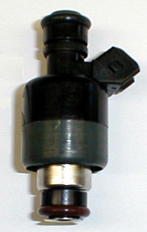

who's injectors are these & what's there flow?

bottom section is very dark green.. I can't get under the hood now.. car is under a cover and under 2 ft of snow but i am so curious to know now. i bought the car with these.
Several flow rates for Delphi injs... Get a pt number off of them. Should be around the top of the black part of the inj...

That is not an item that you would have for just racing. I just assumed that you would have a modern chip in the car if you have 50lb injectors, since stock ones are more like 28. Most new chips call for at least 43 lbs for the regulator, which the stock one is not. But, like most things, I could be wrong. If it idles great you probably do not have the stock chip, anyway. If it is the stock chip then you would not believe the much better idle and performance gained with a replacement. Anyway, I would bet the last owner replaced the stock chip with the injectors. Come to think of it, maybe that regulator is not stock. Are the last three numbers on the regulator 233 or 237? 233 is stock. 237 is the upgraded Park Ave. regulator.
Steve, thanks for the info! this is the kind i'm looking for.. I have no clue what chip is in this car but i am 99% its not the original. Before the snow storm ( I'm out in eastern Long Island ) we just had ( We got slammed & i can't get into the car right now ) i looked at the chip & it has no markings on it. The Previous owner just told me that the car had a "thumb wheel" device for the chip that was in there but the car didn't run great. he put the "other " chip back in ( which is the current one in there ) and runs much better but can't tell me who's chip it is. That FPR is a stock 230 . I've read about the 237 that also came in the T T/A but again this is brand new & the car runs fine with it. I think in the spring when i can drive the car everyday, i will get the urge to make it a mid-high 12 second car.. I can't wait to get get the part #'s off the injectors to see what they really are! Also need to see what fuel pump I'm running.. He had the Tank replaced with OEM tank & most likely has the OEM Fuel pump. This way i can see what i need & don't need to spend extra moola

February is finally over !! the weather was decent today so I uncovered the car and satisfied the curiosities that i mentioned above.. my car has the stock 233 FPR, at idle with vac line is shows about 30-31 lbs. The injectors are the 37# variety - Delphi 1709034 . I did a couple of runs on an empty stretch and she does pull well to around 14 psi but not strong enough to break the tires loose on a roll. I know the car does not have a Hot wire & don't know what fuel pump it has but i think my next step is to run a hood mount FP gauge so i can see what's it doing under full boost.. I also know that i'm not running a 160 'stat. Scanmast is showing me about 184F. I wanted to see what my recorded runs were on the Scanm. but i deleted when i switched the motor off ! : (..
