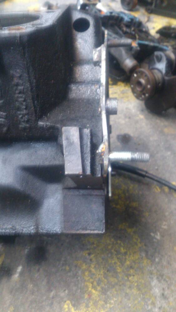

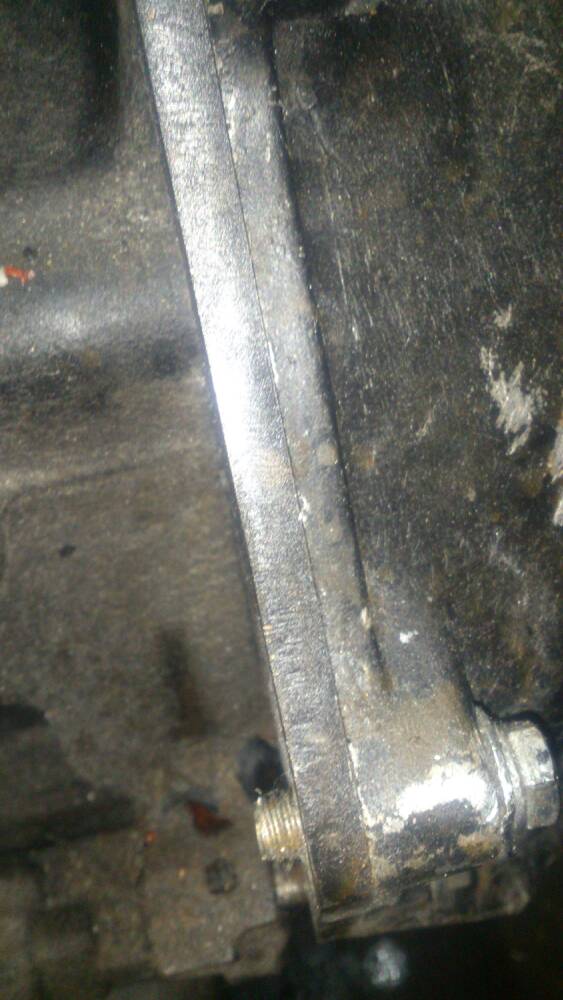

I talked to Lonnie a while back and he did a bellhousing adaptor for the 200. I have since decided to go 4L80E and was going to give the Speedway adapter a chance. I already have a trans adapter designed that looks just like the Transmission Adapters system and won't need trans or engine modifications. I am now considering having made. This is why I wanted to know what the failure mode was.
Thanks, Dan
I will get some pics. Local engineer was surprised it lasted at all being a 1/8th inch peace of mild steel we found out lol
Hey delco about your set up , you were only able to get 19psi out of engine before maxing out injectors?
We have run 21psi and 30+ accidentally for a 3/4 pass before the map sensor hose blew off and killed a headgasket lol we run straight 110/130 avgas so hard to detonate
Old plate and New 10mm thick custom made replacement
I'm surprised lasted that long. Maybe if it was stainless or really high nickel there wouldn't be an issue.
Yeah the speedway motors plate from USA lasted 3 years no issues and ran 10.8s

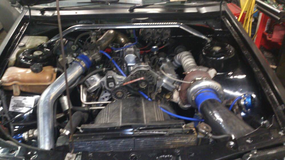

Could you provide a couple of pics of your setup? I just watched a 30 min video on the LN3 block on youtube. Lots of refinements on this block, it's on center, the injector placement. Beefier than the LC2 and the FWD block it replaced. Didn't realize how much difference the injector placement makes.

We've been beating on this one 300000km engine with cam and springs for 5 years just went 10.5@129mph

Now that is weird looking set up.... I like it
It reminds me of the hot air setup kinda, but flipped. I like it as well. How's it going with your 3800 project? Are you on the road or waiting on spring to come?
