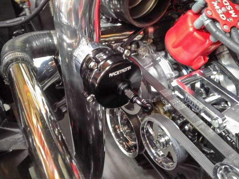

This is my first year running one. For years I have not had anything in place. Got one from Racetronix over the winter and it works and looks great.

I have no axe to grind with those that run a BOV or those that want too. I bracket/grudge race my car anywhere from 6.9 to 7.3 most weekends spring to fall. I've been running this 6262 JB from Precision from when it was first introduced...Patrick Rubio was there at the time. This turbo has about a million passes on it...with no issues without a BOV.
Mike...your engine bay is disgustingly neatly detailed.:)
