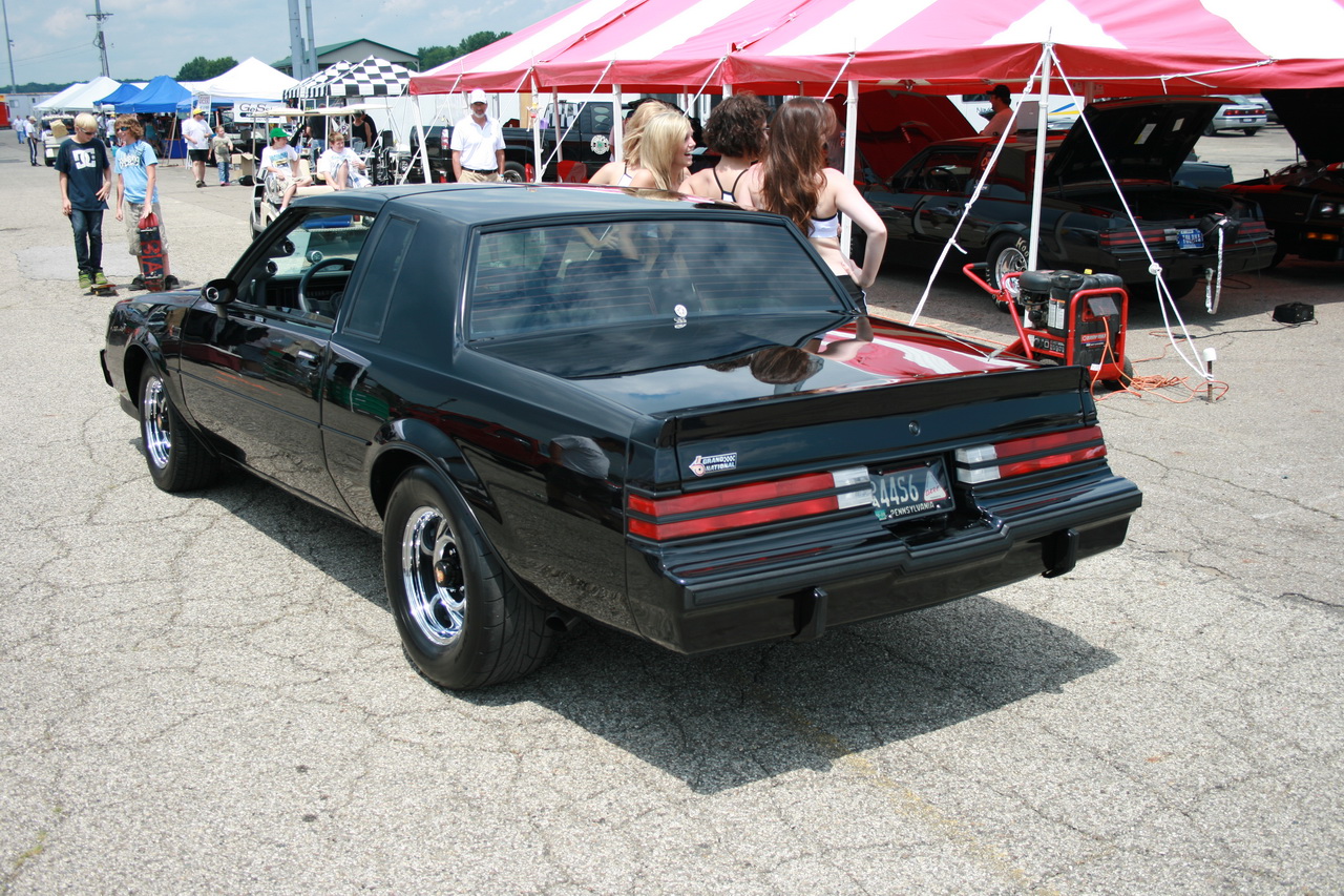

Here are mine...widened GN wheels 15"x8"s with 275-60-15 tires on them. I had them done locally a long time ago but now, I found out that Jim Lyon at True Design Wheel makes them now. His work is top notch and he can make them any width you want!
Claude. :smile:
toofastforyou, very nice, that is just the width I'd like also. I think it fits just right! Thanks

I have the widened rims from Jim Lyon @ True Design as well. I did the 15x8.5 on the back with Nitto 555's 275/60-15 and re chromed front stock rims from him with stock tire size on the front. His work is great. I just sent him 20 GN rims for cores so he should have plenty in stock for everyone! :cool:
Kinda hard to see my rims in this pic sorry! :eek: :biggrin:
What car...ohh I see it. LOL
