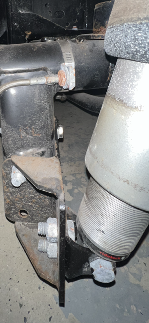

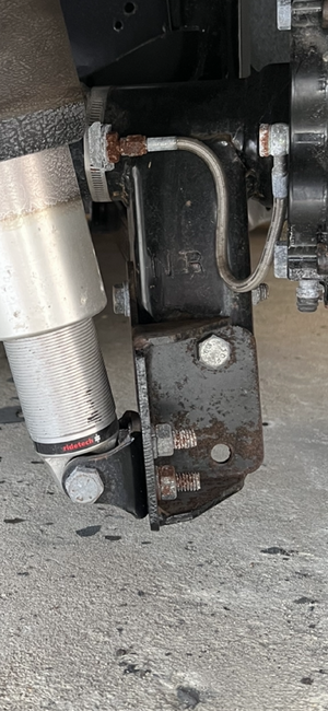

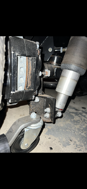

Here's what I have now. Absolute garbage! I'm doing a mini-tub and I'm eliminating the spare-tire well. I'll ask them if they can fabricate some mounts and install, then re-powdercoat. Also, Moser's powdercoating is about as good as their shock mount brackets. Ridetech's, too. Thank you for sharing. At least now I know it can be done.

There's always a talented fabricator somewhere near the big cities that can either take your current bracket and make it do what you want or start from scratch.
Moser has that weld on bracket Mark posted, for some reason I think with the HR rear swaybar it might've been an issue though, not 100% on that.
