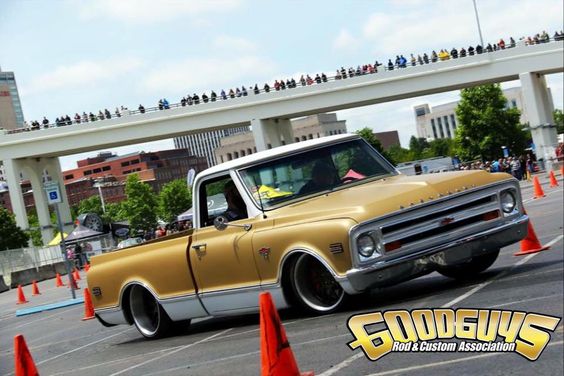

Did it again. This time on the old 245mm Direzzs. Turned out one of my Welds actually wasn't round. It's back at the factory getting corrected.
I lost to an LS7 powered C10 pickup with 600 horsepower and a full frame replacement and Detroit Speed suspension, and 305s all around... By 0.2 seconds.
]I finally swapped out for a manual master. Telemetry shows I'm able to brake at least 1G, so I think the only thing you'd gain from a hydroboost is extra weight and flat spotted tires. I am very much looking at the new aluminum drums Kirban is about to start selling. I think with the reduced weight and better heat shedding, they might be almost if not just as effective as a rear disc conversion without any of the cost or hassle.

Was that the Roadster Shop C10? If so that thing runs pretty damn good, I've seen it at Good Guys Fort Worth. Sounds like your car (and driving skills) are doing well! Keep it up.
It was Mark Turner.
I know he runs Good Guys events, but don't know if he's the one you're thinking of. There were two other C10s with similar builds there, too, but his was a beast.
I just got my wheel back from Weld, so I'll have the big rubber back on for this upcoming Sunday. If he comes up to Louisville for the event, I'll have a surprise for him.
