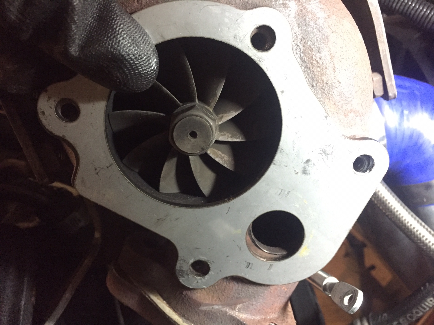

No problem, sorry for the late reply i've been kinda busy. Funny you mention the puck and hole in the housing not mating properly, it's always been in the back of my mind my that may be my issue. My exhaust housing was ported to my old downpipe, and with the new one the hole wound up being off center so i just got one of those plates with the hole already drilled in the correct location for an RJC DP. there's a section of the exhaust housing i could see when dry fitting that plate onto the housing, so that may be my issue.
edit: here's a picture of what i'm talking about.

Be careful porting that puck hole, ask me how in know.......:eek:
Nothing an RJC block off plate, an external waste gate and new down pipe didn't fix......... oops.:(

Lol, yes i'll make sure to do it slowly. thinking about just porting the exhaust housing to the under edge of the plate. not sure yet though, gonna get a couple opinions from guys more experienced than me before i do anything

Granny,
I dont have a plate between my down pipe and turbo. You should only contour/port the inside of the housing and not extend the outside hole size of the housing unless absolutely necessary to reduce boost creep. Contouring the inside of turbo housing first in the shape of a valve seat- then installed it- that should reduce your boost creep. If not- then only extend the outside diameter of the hole a little at a time and then install the turbo to check for boost/ minunum boost that can be ran on the turbo. Good luck- its just time consuming but its winter time- Lol
