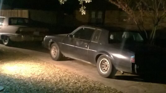

215/70-15 front
255/60-15 rear
on stock wheels.

Yup, I had the 255's on stock wheels previously. That's the best you can do with a 7" wide wheel. I'm honestly wondering if a 255 would have the same contact patch width on a 8" vs the 275. I'll make a separate post for that. In regards to front tires I think the sweet spot for me is the 215/70/15 on a 15x6.
