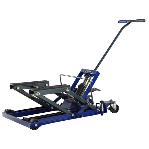

This is what I use. Works great for gas tanks too!
