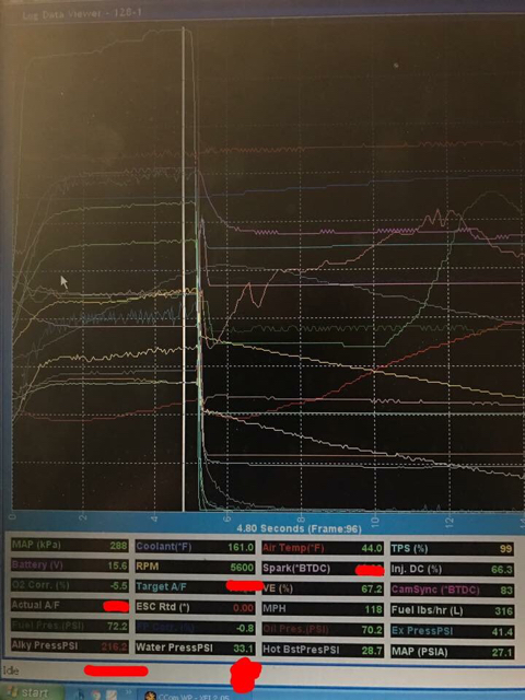

I actully made something similar for a buddy's champion intake manifold . I have a video of a test setup I performed . This was the first test but it has performed well after some fine tweaks .
Nice. Did you get to run it? What were the results? I'm in the planning mode for my new build. Always looking at different things.

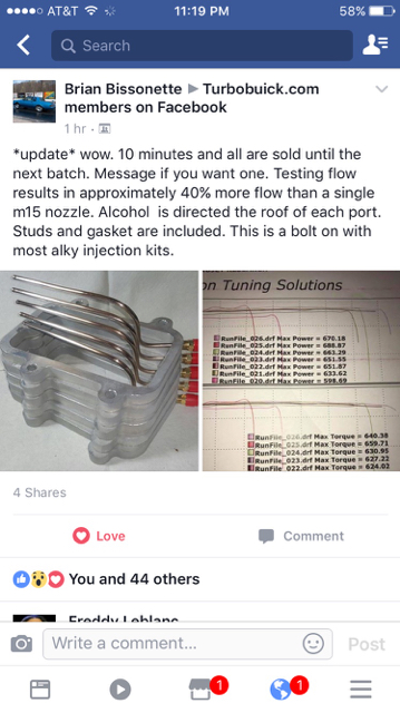

Accurately distributing and burning more fuel isn't re-inventing the wheel. Its what more successful racers do to win because their engines will make more power. I was using methanol injection well before 99.999% of guys that race Buicks were. Well before the internet evolved into the joke it is today. You can burn more fuel safely with this if you take the correct approach. No longer just an anti-detonant. This is made to work with any pump/methanol kit out there. What you need is the correct pump and inlet configuration and higher pressures. I've already been close to 700whp with a low CR and stock shortblock using this plate and 93/alky using the standard size holes in the tube. More pump, more volume and more engine will net a lot more power. The more fuel you can burn the more power you can make. You want to see for yourself. Tune your engine on a dyno on 93 octane gasoline at a low manifold pressure like 15psi. Use lambda for a/f. Then with no other change simply cut the gasoline down to 50% with ethanol. Do not change any other settings. No added timing or a/f changes and make another hit. Report back when you are done.

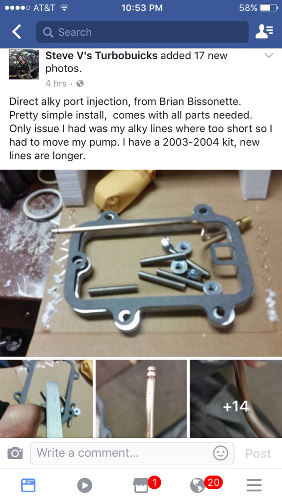

Looks to me like Bisons kit is quite a bit more complex than what it's being given credit for. I do have this kit and it is installed. However, I have a jumper that I need to install to test it.

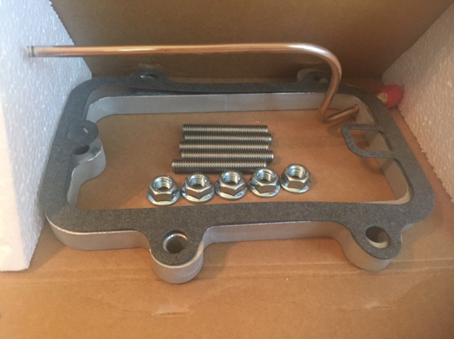

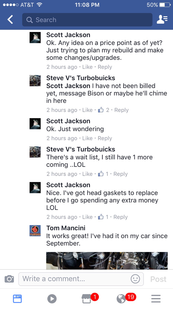

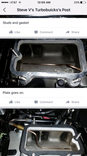

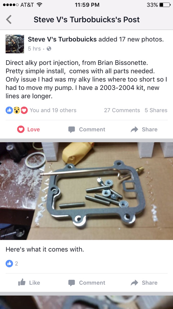

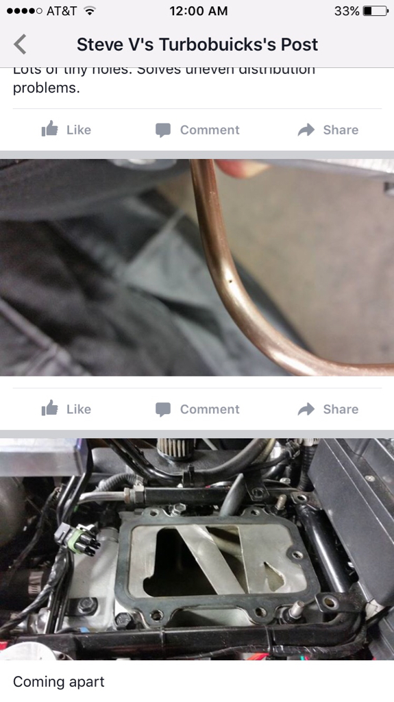

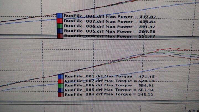

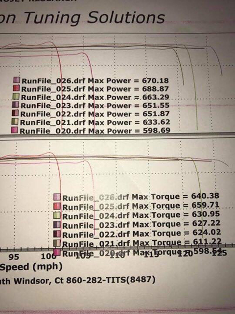

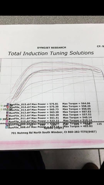

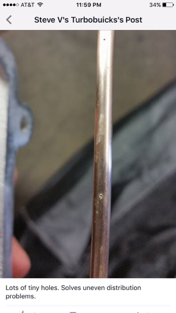

I hope no one minds me providing the images of a Facebook write up (which is what sold me). In the next post I'll post numbers that Bison had from the kit.

Bison is a really modest fella and not very self promoting. However, you can tell there was quite a bit of thought put into the atomization of the fuel being dispersed, the size and location of the holes, the direction of dispersement, the type of materials used and much more, I'm sure. So, theres a lot more to this set up than meets the eye. And it is not just a piece of tubing with some holes drilled in it, that's for sure.
