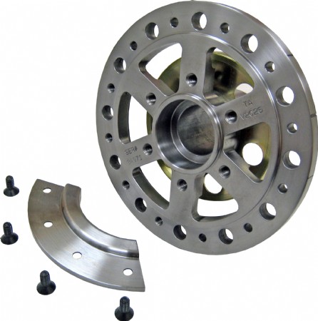

I never liked the traditional JW "Wheel" due to the incredibly heavy weight.
I think they make a lighter version of it though with holes cut in it...

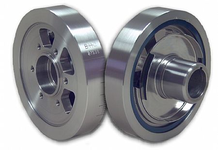

As far as balancers are concerned... I'm not positive, but I believe the BHJ unit actually works as a vibration damper, (using an elastomer ring) whereas the stock replacement unit is just a hub to mount a pulley on.
Can someone verify this ? as I'm about to buy one soon too. ;)
Edit to add:
Looks like I am correct... the BHJ balancer is a much better unit and uses an elastomer vibration damper.
Now... if they made these out of lightweight aluminum, it would be the cat's whiskers. :D
Our SFI approved balancers are of the Encapsulated Elastomer type and are specifically made for Buick engines, not retrofitted Chevy balancers. Our balancers fit like originals and use original type pulleys, while giving you the security of a high performance balancer that can handle the most severe combinations. Our Turbo V6 balancers incorporate the crank sensor ring for proper triggering. Most are available as original type External balance or as Internal balance for higher end combinations.

JW does make a lightened version of The Wheel for the Buick V6. I highly recommend it.

if using the BHJ balancer
place a center punch mark on the inner and outer rings, ( on the face)
Was up to Duttweiler's, he has seen alot of them moving .020 to .060 after running. which alters timing.
This would change how the operator observes the timing to be. The actual ignition timing would only change if the sensor ring on the hub changed position. But still, that's a very good point. It would be important to be able to realize how the timing mark has changed position on you to keep you from freaking.
bhj
so you are saying that Kenny has seen the balancer's inertia ring actually spin a c-hair while after being run? Now that sounds like a good investment for $500! Thanks for the good info, I guess I'll be purchasing it anyway?
what else is there?
Some, not all!
thats why place punch marks, to see IF it moves.
