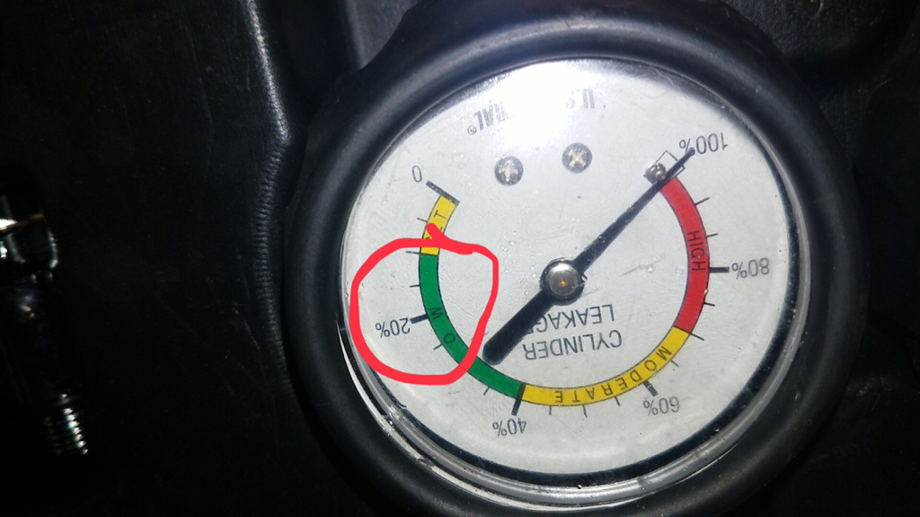

I did that 20% on number 3

We need to know all the cylinders. Doing one is pointless
If it’s 20% across the board on all cylinders cold, would we call that abnormal?
I’d call it good.
I’d call it good.
Cold. Still would like it less but if it was all even I would be checking other things as well
20% still well in the green.
But I agree. I’d still just check everything over while there.
even when I did the compression test warm. then I let it cool down did the numbers again it was same.
