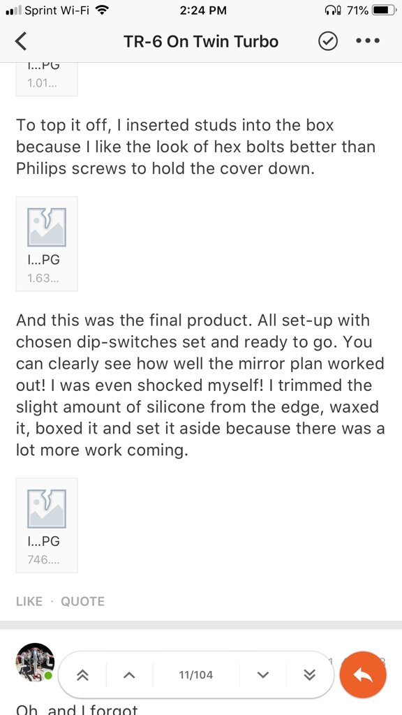

I did. I read you had Holley coils. However the only pictures that loaded were the ones with the stock coil pack. Final pictures didn’t load. That’s why I’m asking.
Sorry for the short, one word answers. I was answering from my phone and hate using it for TB.com.
Yes, I'm using the big coils. And I'm sorry you couldn't open everything in the thread attachment. I'm proud of that little thread from last year and was hopping you would scroll through it.
