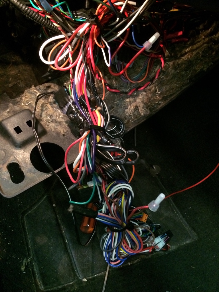

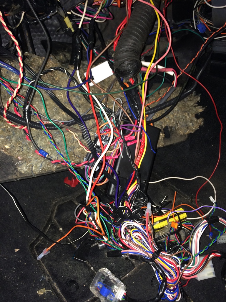

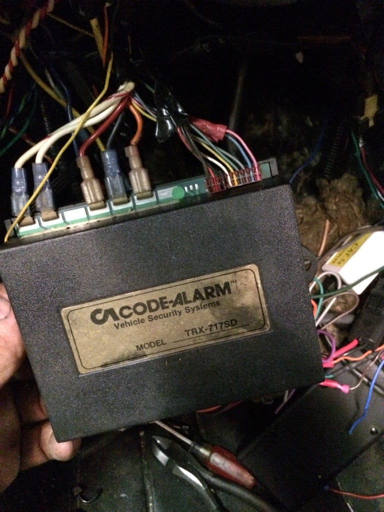

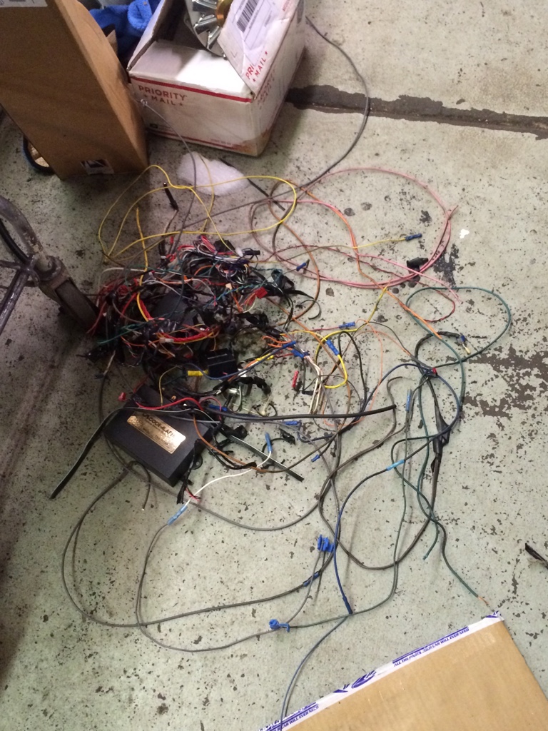

2 hours to back all this crap out and they cut into more than half the wires on the column. The solenoid wire was 100% interrupted. $200/hr isn't enough to deal with the grief of this type of work

Bison that looks a little like my rats nest . My Viper system seems to work ok , it will even remote start the car but then it dies 3 seconds after it starts .
