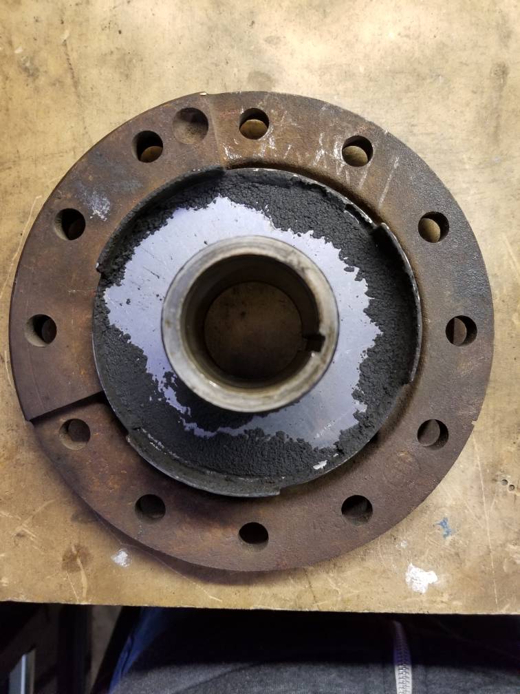

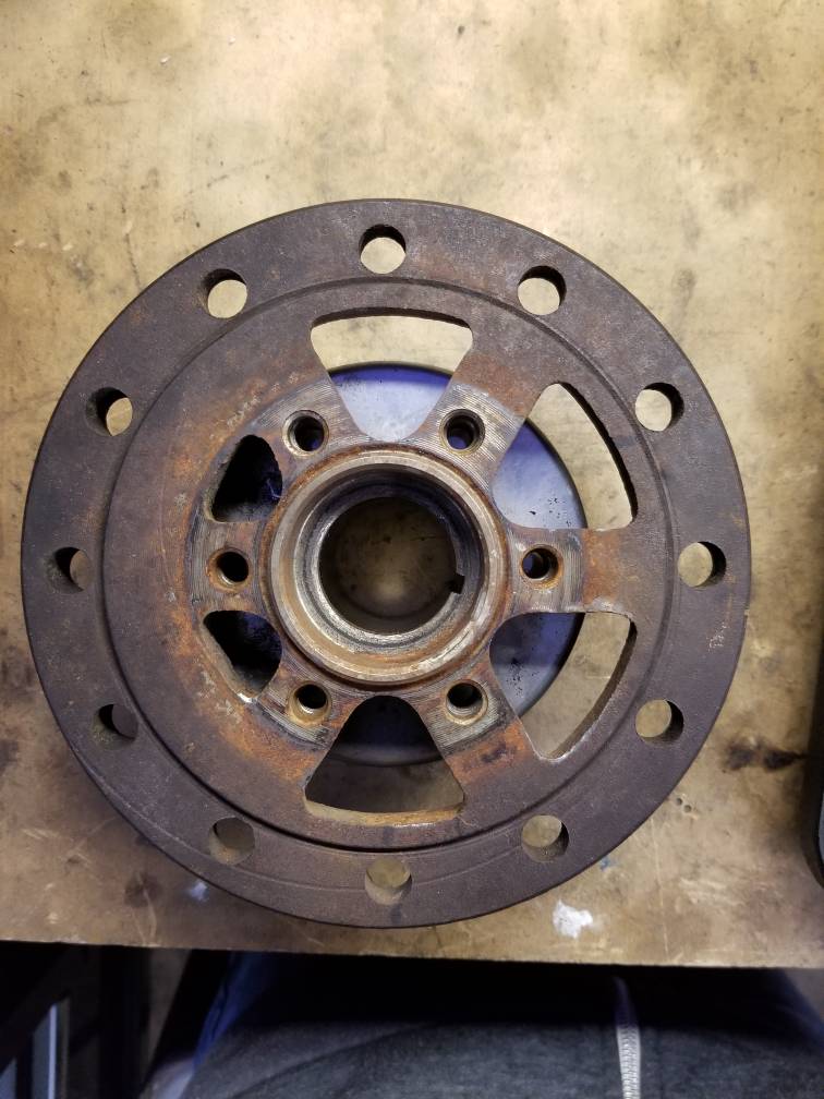

It had a good wobble for sure. I'm about to pull the balancer off. Someone has been down here before, there's a polished timing cover on it.

Jk about the polished timing cover, it's just this piece attached to the balancer. I see no visible crack...is it common for them to warp?
That's the thing. look at how close the threaded holes are the center mass. Even it it did warp, the area the hub bolts to won't be effected.

I'll check the crank snout, but I'm with you on that it would have to have a serious bend in it to cause that much runout. And I just don't see how that would be possible. I'll throw the balancer on my lathe tomorrow and see what can be done.

It is indeed the pulley, but it's appears it's not warped, but un-parallel to the bore. I bought one off a member that he's sending today.

The balancer. The bore wasn't cut perpendicular to the mounting face for the pulley. I'm sure it could have been cut and not cause any problems, but I replaced it with another stock balancer.
