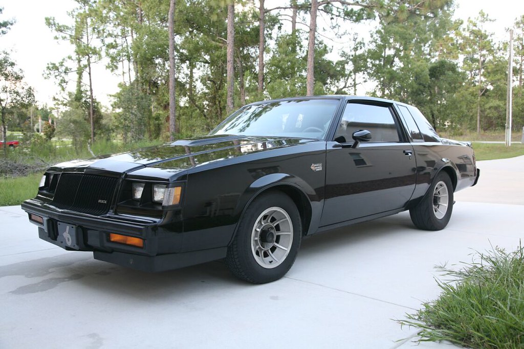

The stock T rims have around 3 3/4 to 3 7/8 backspacing (my measuring isn't exact, but you get the idea). The 255/60's fit perfectly. I wouldn't go with anything wider on a 7 inch rim because the sidewall will be pinched in and the contact-patch won't be ideal. Here's a pic of the 255's on my car:
Here are the 275/60/15 MT on the t wheels!!!

After running the 275/60/15 dr on t wheels i have noticed that the rim is really too small for that tire imo. As others have said the 255/60/15 would be a better fit. I am getting new wheels and will be going with 15x8 on the rear. Just not sure which wheels to go with yet.
