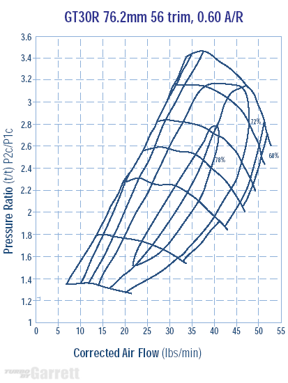

The GT30R is kind of a freak turbo. A friend of mine with an ITR made 525 WHP at 22 psi of boost, with a straight up GT30R and a .82 A/R exhaust housing.
Those dang Hondas always break the rules :D
Ill bet on my Dodge Id be lucky to get within 75 hp of that with the same turbo :( I also dont run lots of timing either so that doesnt help. At 500 whp, the car is only getting 12 degrees total advance.
