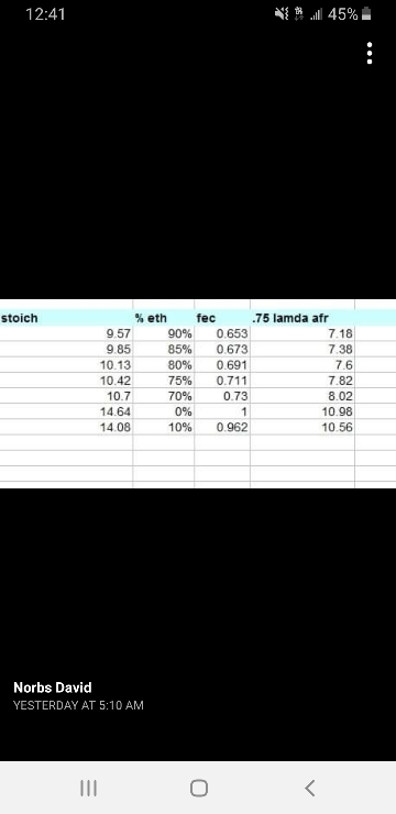

I asked previously and have never been able to find a table listing %Ethanol vs FEC. Are you aware of a table?
Nope. I'm sure there's a somebody that knows. Eric might, or Matt Cramer at DIYAutotune.
I'm just using the sensor and the settings Eric gave me for the ECUGN. I have sigs turned off, so I did't see the OP is running a standard TT chip. Which complicates running less than E85. Getting down close to E50/E60 is going to require fueling changes that are probably outside the authority built into the chip.
Thanks for the reply @Turbo6inKY
I recall reading that the percent of ethanol to FEC is not linear because it's frequency based sensor. This is likely the reason why it's so difficult to locate any info.
@Eric Stage I any info on this?
I'm now going to add injector cleaning to my spring cleaning every year .
I believe this should cover it. This doesn't apply to the ecuGN, as it uses the inverse of that number.
