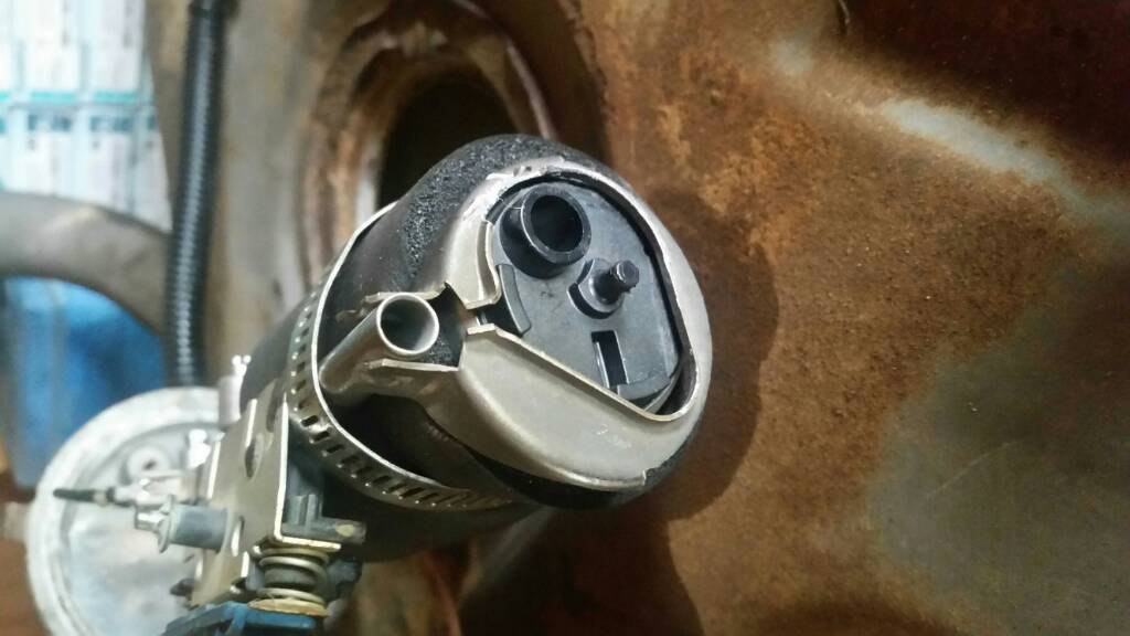

Hey guys, having a problem. Just installed a DeatschWerks DW200 fuel pump. When i try to install it back in the tank, the fuel filter hits the bottom of the fuel tank. Anyone else had this problem, it has the factory tank with the internal baffle. Thanks guys.

How timely as I just got a DW200 myself and it's going sometime next week. How would you have to clock it so it doesn't hit the bottom? I had heard of prior issues with the DW pump not fitting as stock due to the offset on the sock attachment point on bottom of pump.

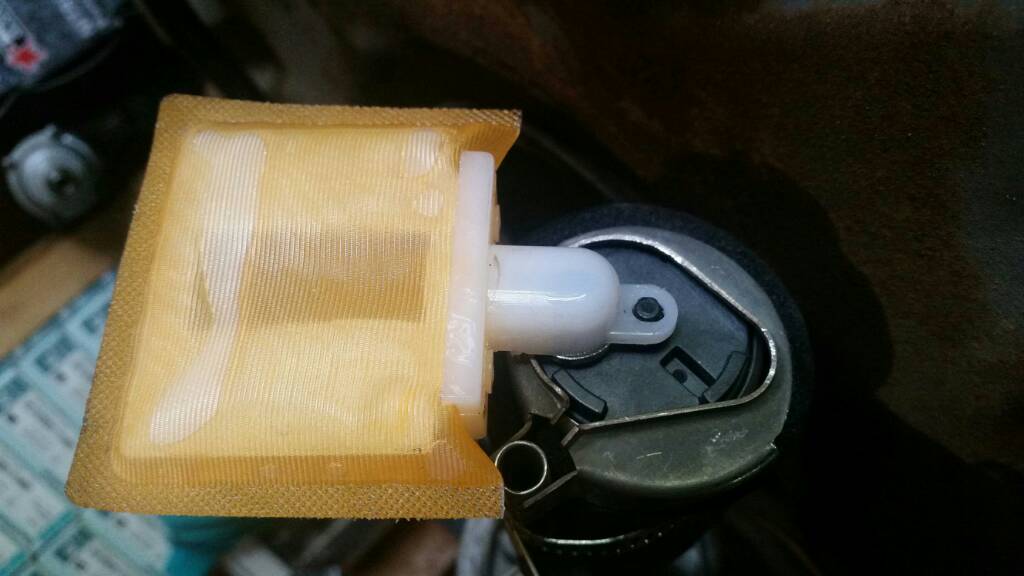

I tried mine without the filter off, and it didn't hit at all. It only with the filter on that's it hits. I might try using a factory filter so I can rotate it around. The DW200 has a locking clip that u only can put there filter on one way. I wondering wound the AC Delco EP242 do the job, it rated close to the DW200.

Yes, it hitting that factory hunk of plastic the tank. The baffle, going to try a factory strainer. That way I can aim it in any direction. DW200 strainer has to stay a certain way.

The metal bottom ring that support the bottom fuel pump, cut it off the hanger stem, then reclock it a little at a time until its out of the way of the baffle.
So you cut off the bottom of the fuel pump support off the stem (hollow tube??) and the rotate the pump itself? Is the pump only secured now by the clamp going around the stem and pump? Just trying to get a clear mental picture. Sorry.
Yes l, the bottom soppurt ring that the factory pump see to rest on. Cut that off, and the clamp will hold the pump on.
