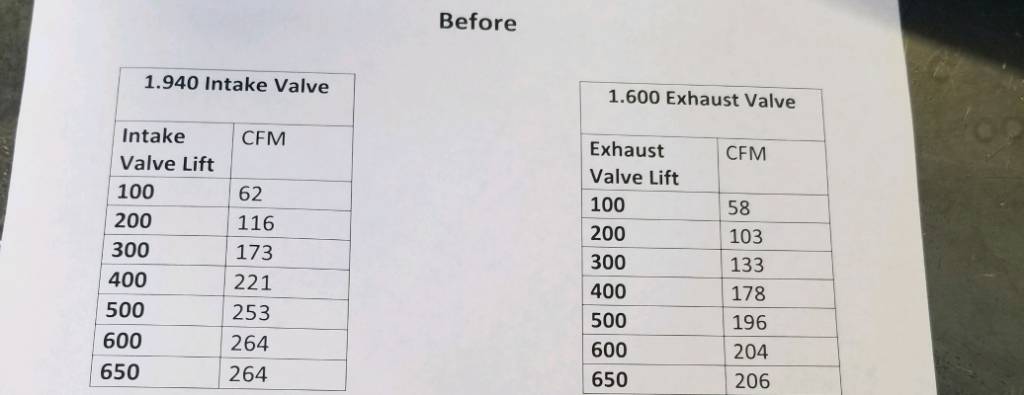

I am curious to see what guys have gotten out of these heads fully ported. Please post your numbers or flow sheets. Also please keep this thread on track, this is not a Champion vs TA head competition, or turn around time etc. Just raw data.

CHAMPION GNR HEADS
INTAKE EXHAUST
100 66.3 100 50.8
200 113.4 200 113.4
300 189.7 300 156.8
400 238.5 400 182.3
500 260.7 500 194.0
600 261.7 600 199.3

Steve your middle numbers are very impressive to me, should make good power with the right compression, cam and turbo combo. Congrats.

Sir,
Are the heads in the photos ported or as cast? In addition any flow numbers and cost to duplicate?

The heads are CNC ported by Champion and flow excellent for my needs, machined, ported , assembled and shipped within 1week.
