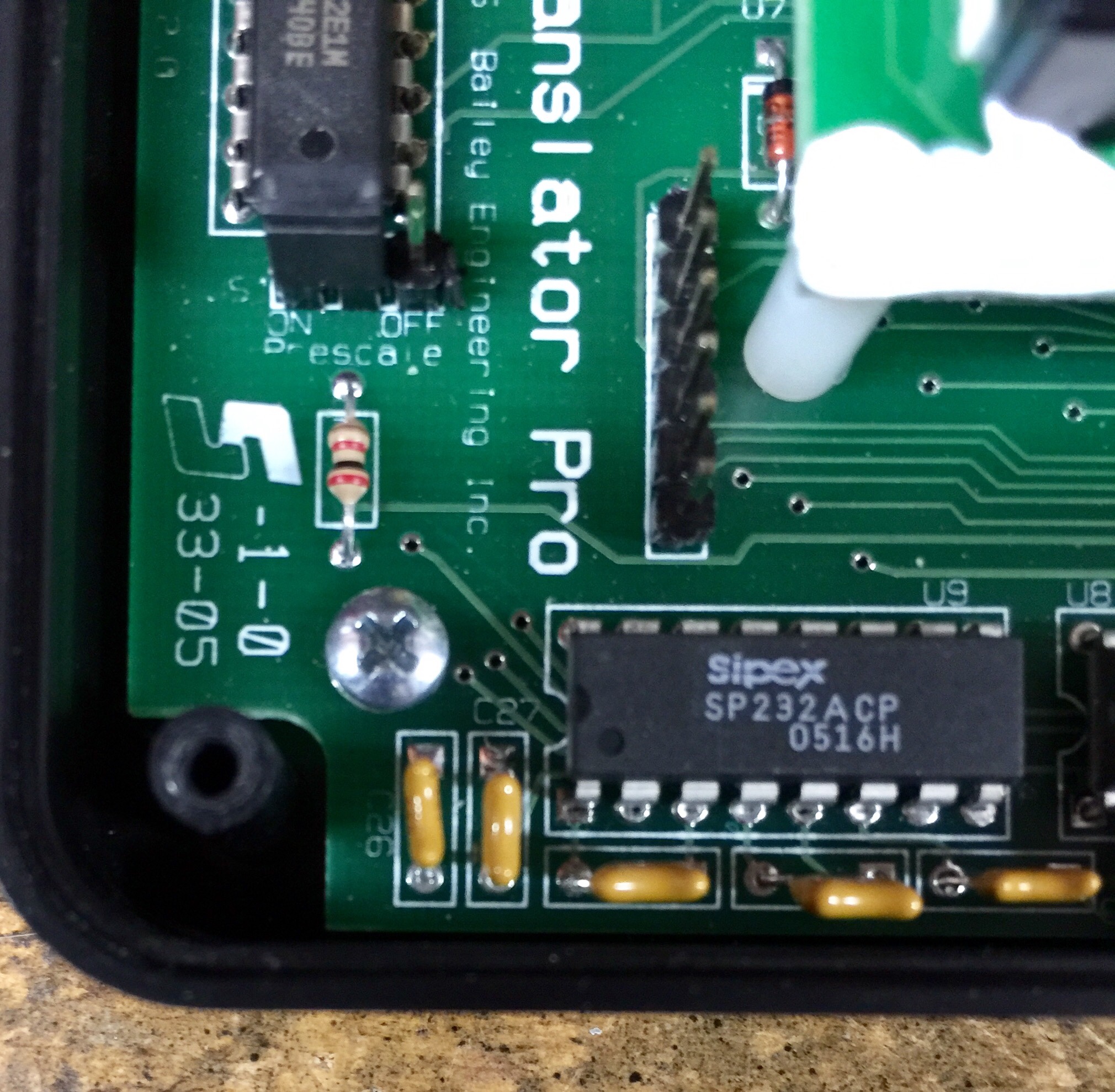

There is a pre scale jumper inside the Tpro that has to be switched when using a maf. I suggest changing to speed density though.

Dug my Translator Pro out and took a picture of the jumper you need to check. If memory serves, it needs to be in the ON position (as shown here) if you're going to run a MAF.

if running SD, unplug whatever MAF you might have on the car. as a note, F-in mode needs to match the MAF sensor when running a MAF, and the Prescale jumper is ON for LS1 type MAFs, and OFF for a stock one.

Interesting, the manual on page 12 says ON for stock MAF.
