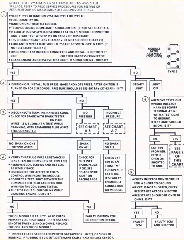

Buddy of mine is having trouble starting his gn. He doesn't have a profile so I'm posting for him. Here's what I know...Compression is 140, fuel pressure only 6-8 psi, plugs are getting spark, and brand new fuel filter. Any insight is appreciated. If more info is needed on car...let me know. Thanx
More Info on Steve Wood's site: http://www.vortexbuicks-etc.com/no_start_tree.htm

fp should be 38 to 42 psi for a stock setup
