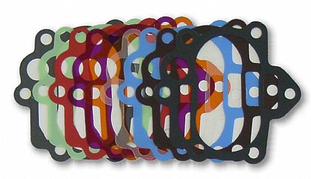

TA Performance sells a real nice oil pump shim kit. They are plastic shims that vary in thickness by .001" Oil pump gaskets vary in thickness as much as .008" depending on manufacturer.

I try to maintain .0015"-.0018" of gear thrust clearance in the pump. It takes alot of hand lapping and gasket/TA shims to get it just right. Another possible source of oil pressure loss, and aluminum dust, is cam bearings.

Ken,
Never heard/seen of oil pump shims!? Got a picture and where/how do they fit the pump?
I'm wanting more idle pressure, will they work for that?

Ken,
