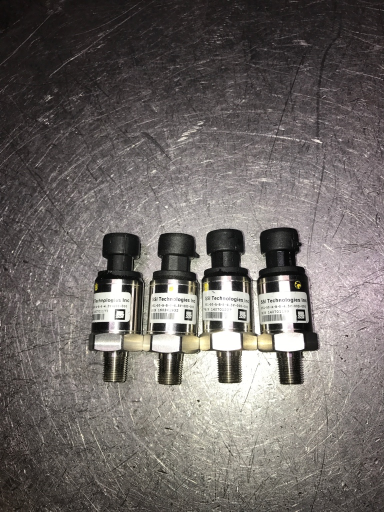

Plenty to go around. You can easily tie this into your existing system. The signal range is .5-4.5v. 5v input only. I have these in 1, 2, 3.5, 5 bar, and 100psia. I can supply harness if needed also. I'd need specifics on length and connectors to make them. Over 300 of these I've used and zero failures so far. Expect more accurate values also

Thanks for the reply bison, whats the price of admission for one of yours for future projects?
Can your MAP sensor feed both the xfi and the alky signal or would you need one for each?
