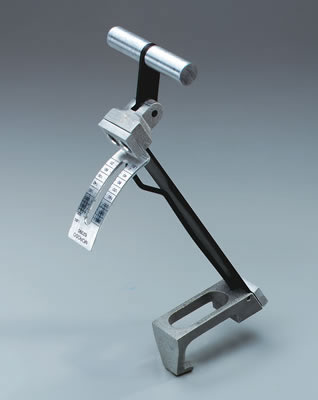

Tested the v-springs in the car with a Moroso tool. Had a few at 100#, 120# and so on. None of them except one was over 160. I should have 200+.
I'd go ahead and test yours if you get a chance for sure.
I think I figured my issue out:)
Which one did you use ?
This one ?
Yes. I have stud mounted rockers. Not sure what you have or if it would work with them. That tool did the job nicely for me.
I think as long as it clears the adjuster nut, it should work OK on my shaft rockers.
You should have no problem. Here is a pic I just took. I was trying to show the clearance. Not the best picture but you can get the idea.

Oh hell yeah... that will work on mine...

I 'gotta order a Moroso spring checker and see what these are...
