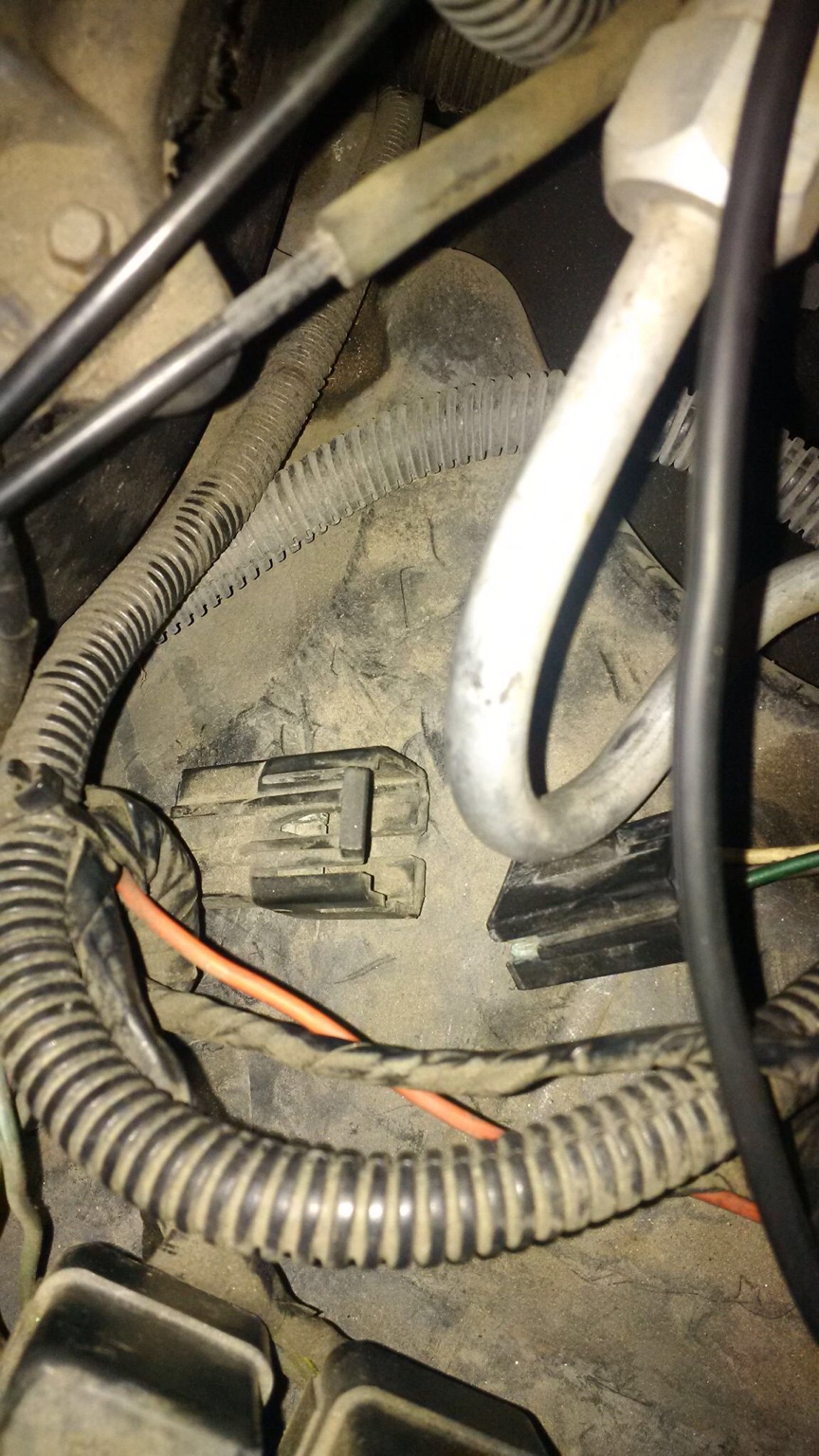

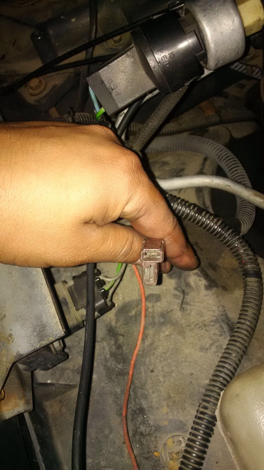

Aside from this, the pictures are random wires that my mechanic left after final assembly six months ago.. I finally took the time to take pictures of to ask wtf it is.
found on passenger side
I'm assuming this one is the motor for the powered antenna because it doesn't shut up when I hook it up regardless of car being on or off. (antenna always up)
no clue. Passenger side.
driver side, no clue. 2 clipped yellow wires, red clip and black clip
Red clip goes to boost solenoid on pass fender the other i cant recall at the moment i have a diagram from whe i did my car i will try to find it maybe ac related and it looks like you need a o2 .but i am not a expert there are alot of guys on here the are top notch and should be able to help

Pic#1 Ground wire for blower motor. Should be a lug under a mounting screw for the blower motor
Pic#2 Plug for power antenna
Pic#3 Connector for boost switch-only used on digital dash.
Pic#4 Boost solenoid

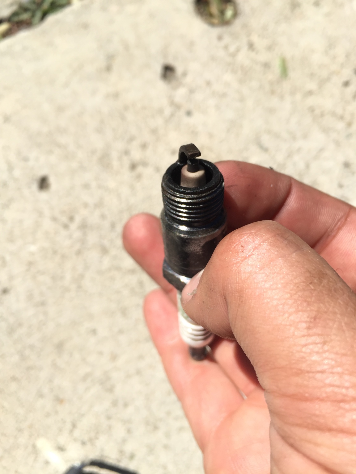

so I decided to change spark plugs. They were gapped .050 . New ones are at .032-.035
Old ones:

Plug # 1
Plug # 2:
What new plugs did you choose? R45s are way too hot. R42s more appropriate. NGK UR5 or my favorite Autolite 23 gapped @ .030 work good.

Sure it's white "smoke" and not steam, from a blown head gasket.
From the looks of that plug, that's certainly a possibility....

That red plug went to the charcoal canister, not the boost sol. As you noticed, it's too short to go to the pass valve cover.
The plugs behind the stereo went to the stock radio. They plugged in on the LH side of the radio.
