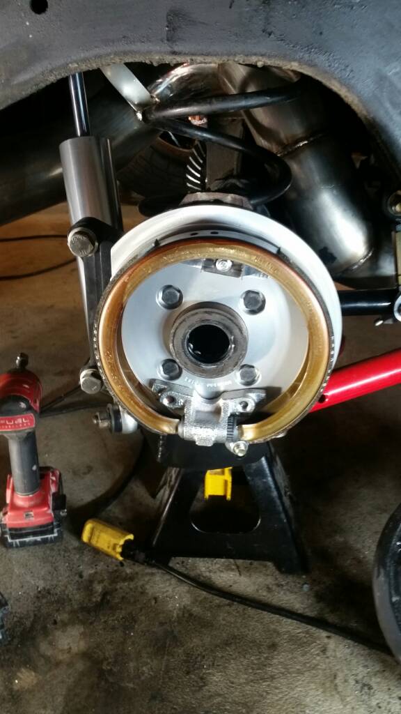

Well I had a little time this weekend to spend in the garage so I started on the back brakes. Drained the rear end and took the TA cover off. This was my first time removing axles so it took me longer that it should off but I didn't mind. So I removed the pinion shaft bolt, then the pinion shaft was able to slide out. Next I was able to push the axles in towards the pumpkin and expose the c-clips and remove those and the axles slide right out. I then removed the drum brake assembly. I will say the anchor pin bolt kicked my ass. It was froze up. Tried heating it and still nothing. Finally with a long box wrench and BFH and some vice grips I got it to move slowly. After that the next step was to drill out the bottom 2 holes on the axle flange to 3/8". Got that done and temporary mounted the new bracket with 2 bolts so I can make marks for the top 2 holes that had to be drilled out. I got 1 side all torqued to spec and ready to finish. I will finish the other side during the week. Not very exciting but it's something to add

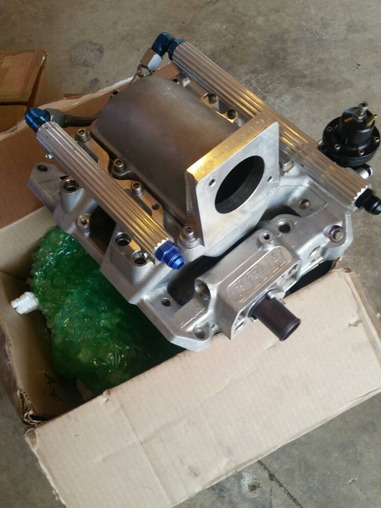

Thought I would update a little. Well it's been a little slow here, don't have a heated garage.

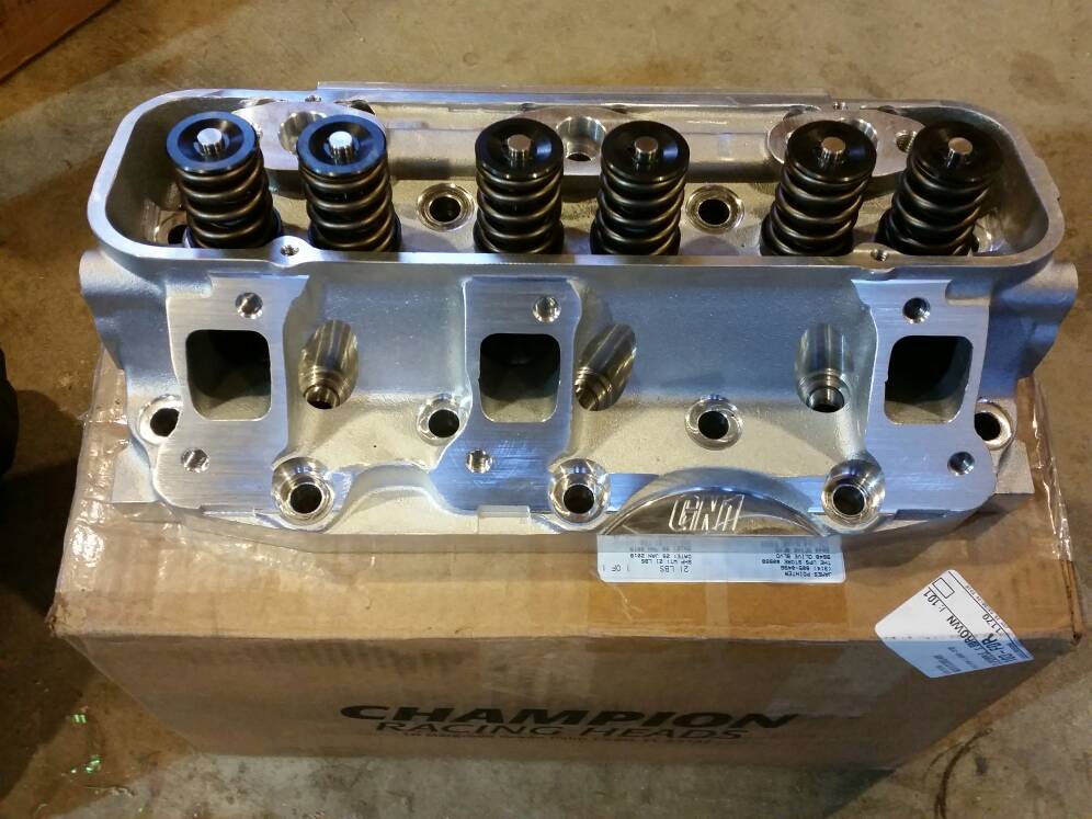

Block is currently at the machine shop. I did get a few more items crossed off the list . I picked up a billet fuel pump unit with a DW400 pump and AN fittings. Got my heads ported, will attach flow sheet. Also got my Gee M headers ceramic coated.
On a side note if anybody is interested in the Champion intake that I posted at the beginning of this thread it is for sale. I bought it used and the previous owner ported it and now requires the gasket to be cut to work right, he failed to tell me this. PM me if interested, or more details
Sorry if the pictures are to big, lucky I can even post them
