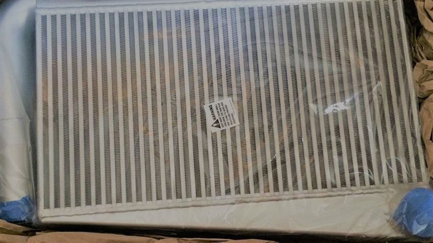

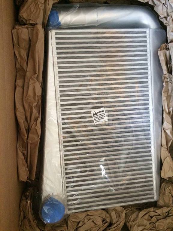

Here is a taste of what the new Bell-designed FMIC's look like... there are 2 options we'll carry.. both are conservatively rated by Bell. 1 core is rated to support 1,100hp and the other 1,600hp. The only real difference between the two cores is the thickness. Otherwise the outer dimensions are the same- 30.5"wide X 20.5"tall X 3.5"thick for the 1,100hp core, and 4.5"thick for the 1,600hp core...
Nice design! Think one step down to something in the 800hp range might be a great seller. Those are great cores...
We have 2 Treadstone FMIC cores that I haven't posted pics of yet...which we'll be testing and if they meet our standards, offering up for sale ;)

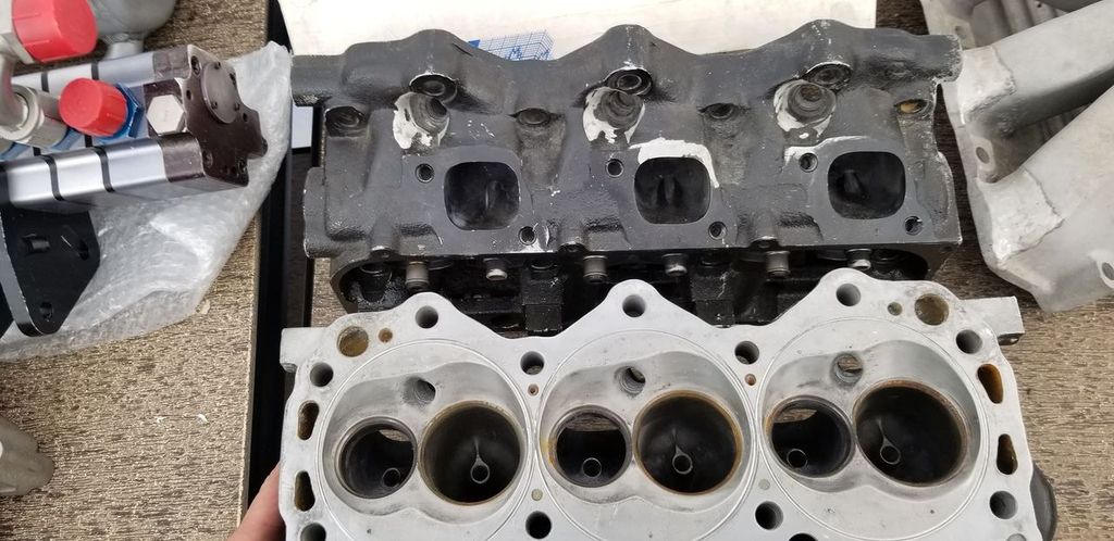

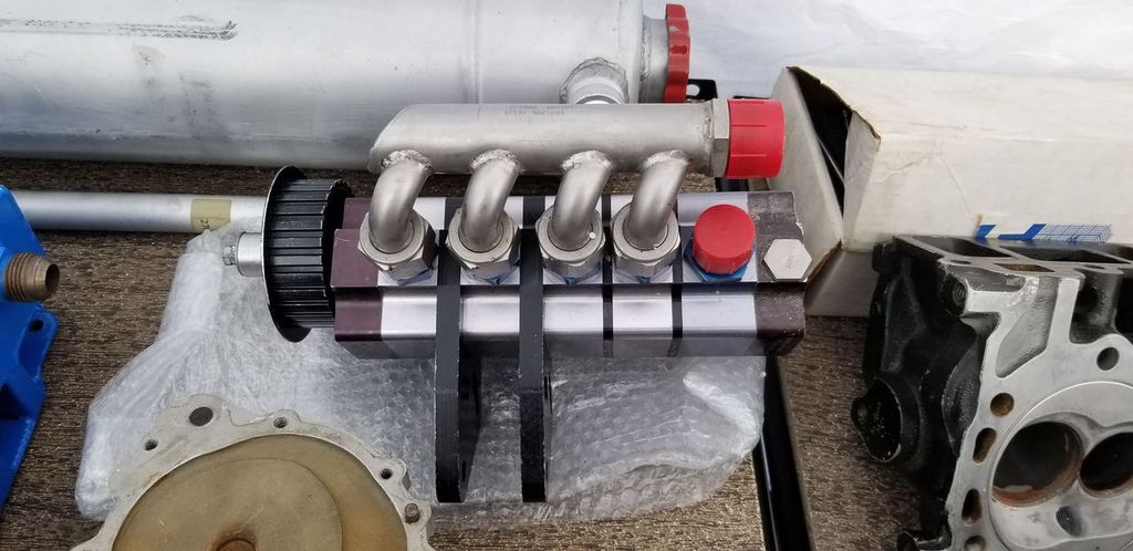

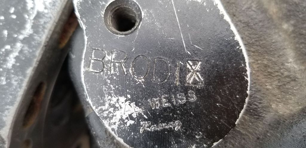

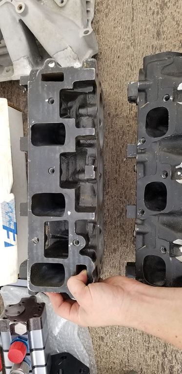

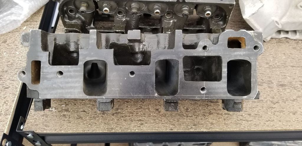

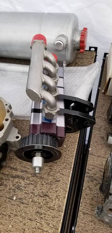

So Travi's heads and intake came in the other day, along with my 5 stage dry sump pump, my dry sump oil pan with windage tray, BMS Stage 2 front cover, and dry sump oil resevoir..

What was wrong
with the stage 2 heads you had?
Mike
These are for my brah Travis. Fucker is building the same engine I am, and if he isn't a whore of a man (meaning, I respect the dude and love his ass-no homo) I'll luckily convince him to have Duttweiler build his engine for him as well.

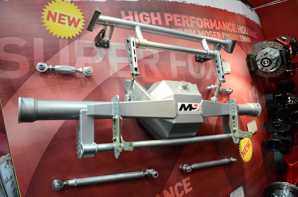

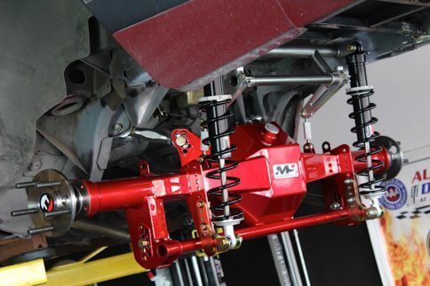

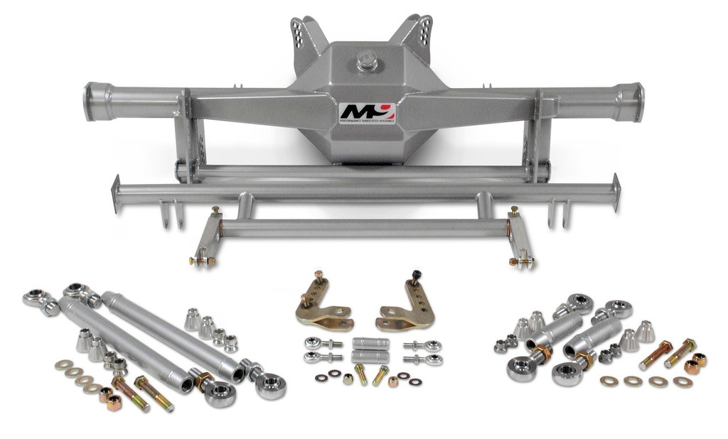

We're both going to go with Moser Super G rear ends, I'll be going with Varishock QS2 coilovers as well.
The Super G rear end comes with relocated lower control arm mounts that are adjustable, and adjustable upper control arm mounts too, along with adjustable coilover mounts. The coilovers mount to the crossmember that welds between the frame rails for strength.
This is what it looks like:
Really fucking stoked for this setup.

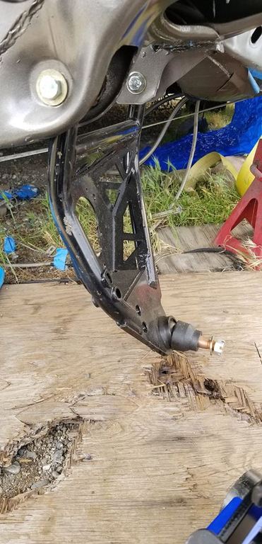

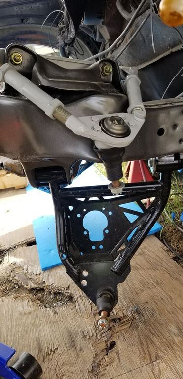

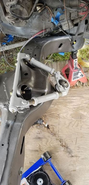

FINALLY got the upper and lower control arms on the car today! And 1 of the spindles too..
