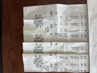

BUT tonight I can say I have got a better handle on it. 3 of 4 passes 11.7
I have not had time to dive to deep in the logs and I need more schooling on E85 plug reading.
Spun the tire all 4 passes leaving around 5 lb.
Ill have time late tomorrow to report back
Where are your boost and timing numbers at?
Thats 10.7@127/129 from the slip.
I remember you making alot of changes.
the 129 was 0 boost leave 29.5 lb at light 21 degrees timing from around 4K 20 lb boost up
I locked the converter on the last pass at 95mph

What were you up against on the last slip? Proves spinning ain't winning. If you can improve you're 60' you'll have a 10.5. Have you tried launching at higher boost? Sometimes hitting harder gets better bite.
28X9 PBR are 5 years old 100% stock location UMI upper and lower KYB shock with a HR bar.
Log looks like tire spin every shift
Im looking at the different rabbit holes I might venture down
And on timing forgot my E85 timing offset + 2
Nice work, looks good. That 6062 provided a good gain over the 5857.

Thats alot of changes but the right way.
Log looked good?
New converter had a positive effect on rpm drop?
When you say locked are you force locking a single disk diode?
Some new rubber and more contact patch
Scale the car/match spring rates with some double adjustable shocks and play😉
