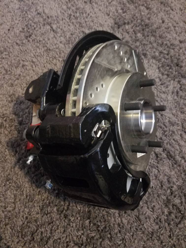

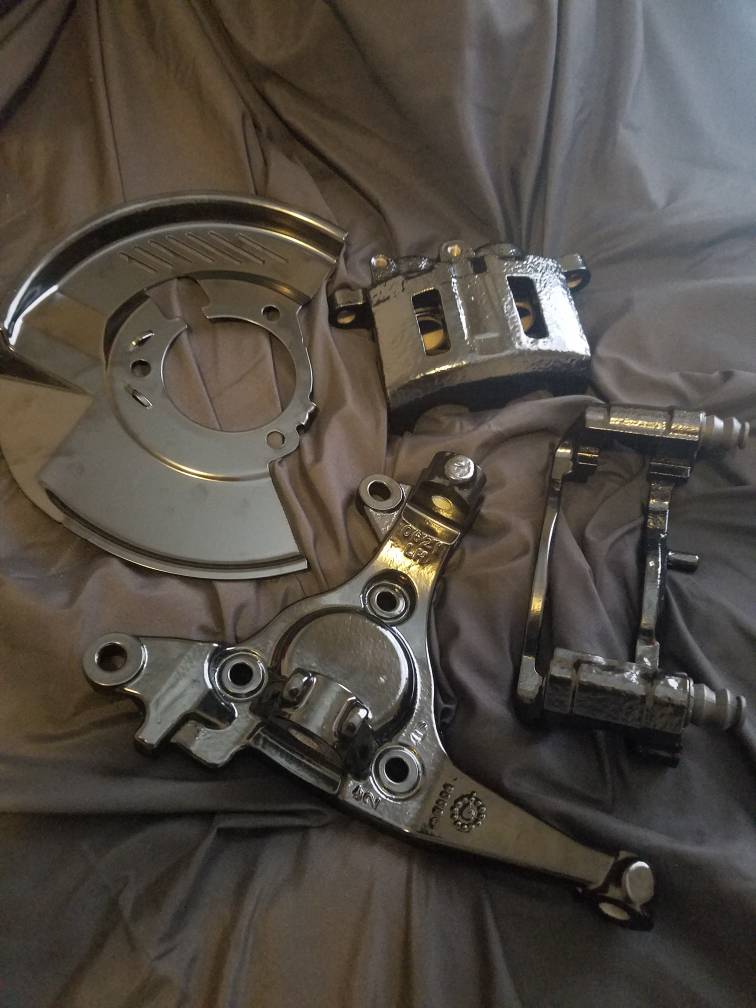

Just picked up my parts from Pete at Prizmatic Powdercoating. Hopefully will have them installed over the next week (if I can get some free time).

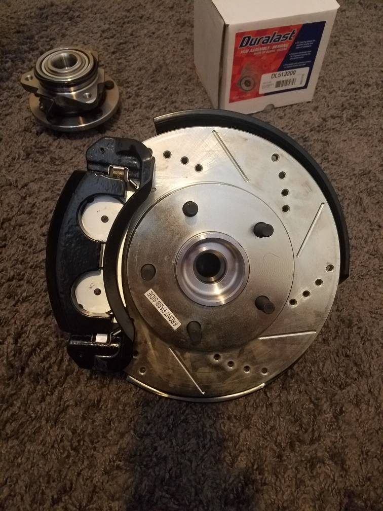

Finally found time to get spindles swapped out. Installation went very smooth. Thanks for all the info guys!

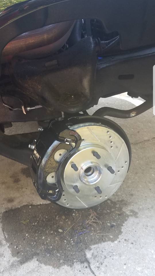

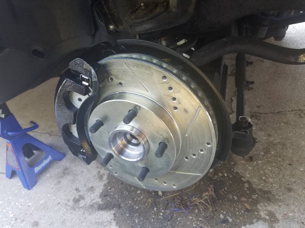

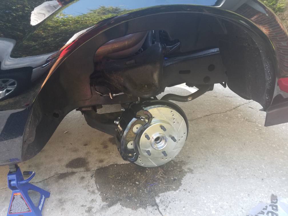

Here’s a picture of my blazer front brake setup . It was a very noticeable upgrade . Also I installed the speedway uppercontrol arms while I was there for $45 each you really can’t go wrong . Taking the heavy stock arms off to help with cutting Alil weight .
Here’s a picture of my blazer front brake setup . It was a very noticeable upgrade . Also I installed the speedway uppercontrol arms while I was there for $45 each you really can’t go wrong . Taking the heavy stock arms off to help with cutting Alil weight .View attachment 310922View attachment 310923
