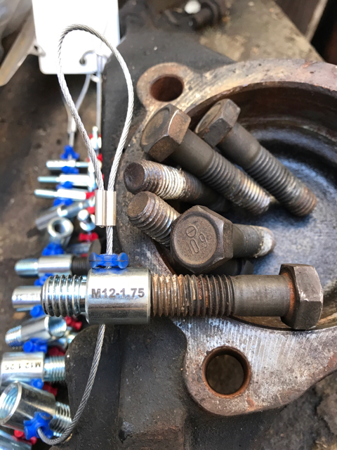

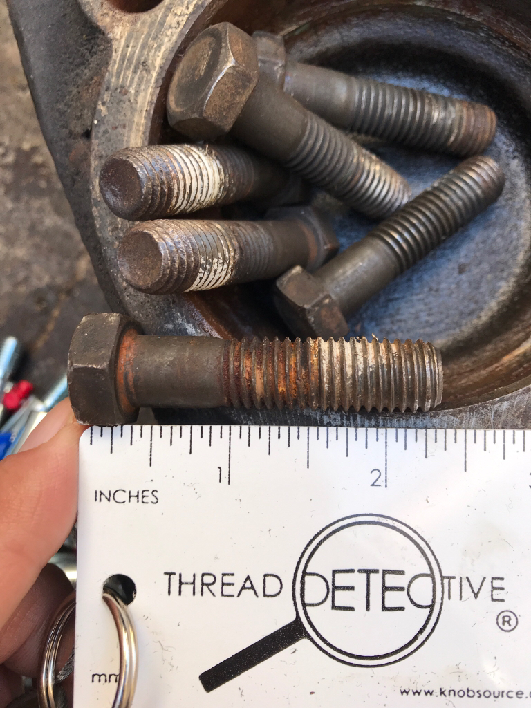

I just received a set from Timo22. I noticed some threads (M12 -1.75) by (2” long) could have seen better days and maybe these pics could help.
** corrected to from 2 3/8" to 2" long bolt.

thanks everyone for the info on the bolts - i for some reason in my old age thought that the bolts were not available from GM anymore - ill check them out tomorrow
BTW- Bolt with a head on it is measured under the "head" to the end. UHL is what they are referenced by.
studs without a head is overall length (OAL)
