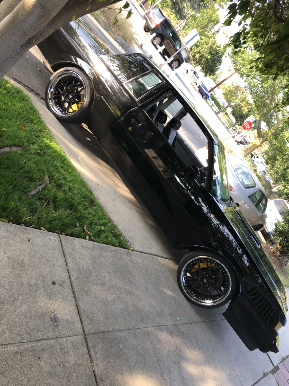

New Blazer Brakes
They are aftermarket stock replacements from earls I belive . They are nice stainless lines
The original write-up I read said to use stock hoses and to cut the rubber insulator off but it cause brakes to bind with hard turning. Looking for alternatives
