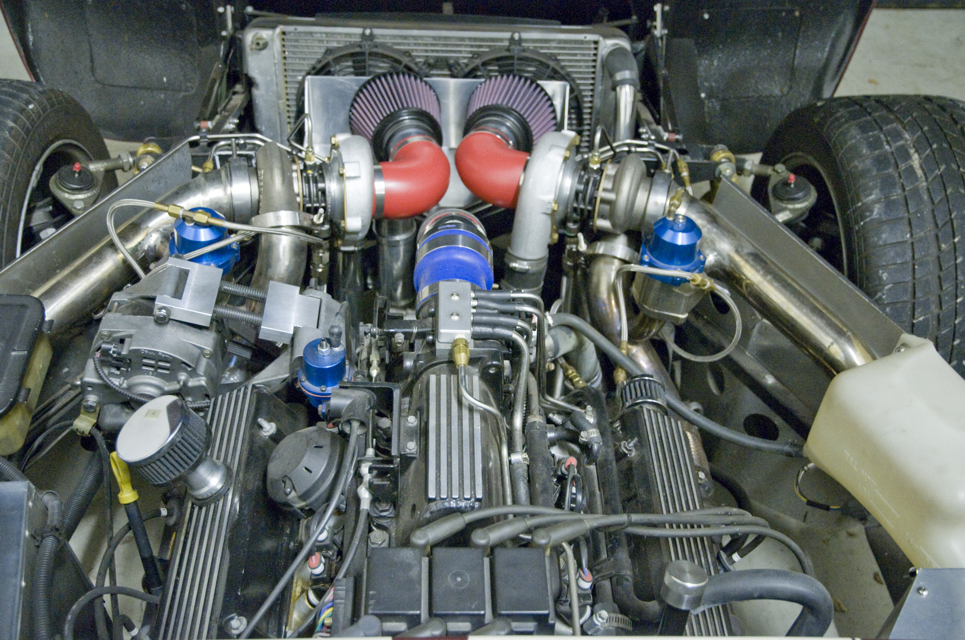

Here are some images of my twin ride using the GN engine:
http://www.gnspyder.com/images/john/spyder_turbo2.pdf
http://www.gnspyder.com/images/john/image03.jpg
I put it in a tube frame 'glass body Cobra but it will give you an idea of layout. Exhaust was managed by twin-tube side pipes integrated into the body of the car. Twin wastegates tied together with a commonly plumbed pressure regulator and the boost is rock-solid. The oil return lines go directly to the oil pan.

very nice car! what sort of numbers you get from this combo?
First "out-of-the-box" pass was 11.80 @ 119MPH, second pass, the car got squirrely, so I aborted until I found the culprit. Turned out the alignment was way off.
The first set of turbos were Schwitzers, tiny little things from a John Deere diesel application. They were only rated at 95 HP. So, I just replaced the Shwitzers with a pair of ball bearing Precision turbos matched to the engine - capable of around 500 HP per turbo. Ran out of season, so in the spring, I'll be making another pass...
