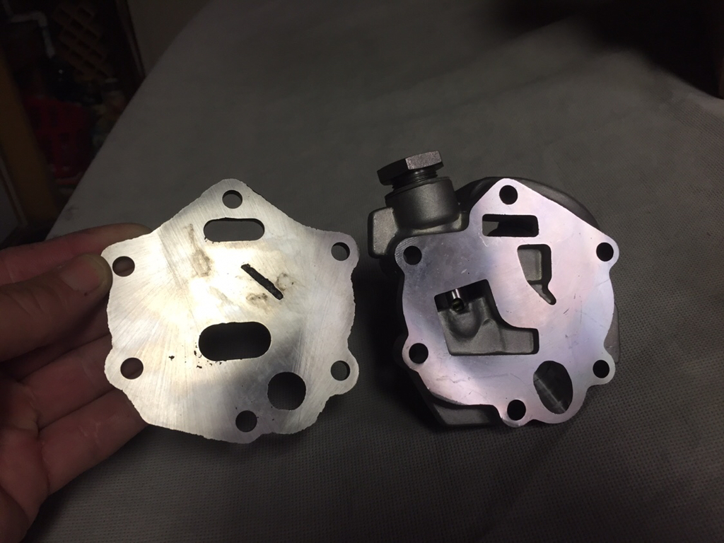

This is what I’m comparing. Maybe it no gain if there is no scoring to correct. Just wondering
That plate is a band-aid for a scored oil filter adapter. It's also a way to add two mismatches on the high pressure feed to the engine. (and double the odds of having a leak at the gasket(s) between the cover and the adapter. There's no performance gain to be had adding that under a smooth filter housing.
That goofy line looking groove isn't a debris trap, it's a path for high pressure oil to wet the fixed pin they driven gear rides on.
Plate is great and a way to keep the end play of of the oil pump gear in check. The gears WILL wear into the alum oil filter adapter and end play will increase. As far as leaks with the plate, Ive never had a leak and have built several front covers and FWIW so did/does Jim Ruggles, TA, DLS, ETC ETC and it wasnt a issue. Theres the booster style plate as well as a wear plate. No way I would build a oil pump without one! Over the years of messing with TR's ive pulled front covers off of cars with less than 25k miles as owners wanted peace of mine with the timing set being replaced and of course the oil pump was gone though. Always found scoring on the oil filter housing!

Agree completely, but I would use a better plate(wink, wink) that's truely flat unlike the Melling one.

Steve good point every Melling P 201 ive used has always needed sanding to be flat. Thats why...insert commercial....Theres Turbo Nastys/Turbo Dojos super flat superior oil pump wear plate available for those oil pump rebuilds!! LOL
