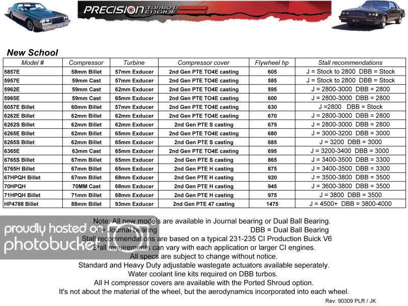

While I am waiting for parts to get where they need to be I was going to ask is there a chart that shows what mm wheels (s) support what HP ?

This is from the sticky in this section on turbo size from precision. Good ball park for stall with turbo combo.
Scott has you covered with the new PTE stuff above. I'm old school so perhaps this PTE old school listing helps bridge between the two. Have to zoom in, but it is readable.
