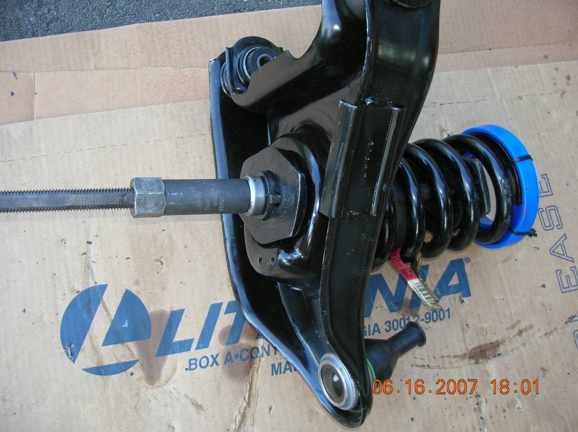

Just did mine. Reused the stock springs after a rebuild of bushings, ball joints.
We tried the old hook style compressor. WAAAY to dangerous. After having it for 20+ yrs, it's in the scrap pile.:mad:
I bought the OTC plate style compressor. Works like a charm, and is easy to use.. Not cheap, but it flat out works! Got it off the bag.
The stock spring was compressed to 11.5" in order to be a easier fit.
I also used new insulators. I tie wrapped them on the top coil at 4 places.
Once all is bolted up, the compressor screw is loosened, and removed. The 2 plates then are slid out thru the coil spaces.
30 min job, vs 2 hrs fighting w/ that old tool.(y)

I just captured that pic off a B Body forum to show how the set up works for the non believers. Some day when I do mine, I'll go this way. With the lowers off or say adding tubular arms this would be so slick.
My hook style would slip free at the slightest jar, bump. After an hr, we said "time out", and bought this unit. I had used that hook unit for 20 yrs, then....:jawdrop:
I do it like that with the hooks, but the bottom hook I made a plate for so it sits just like the OTC unit. Never had an issue or failure with it.;)
That would be a better mousetrap. I found the hooks slide way too easy> I tried locking them w/ a vise grip until I had it really loaded. Went to install w/ the grips off, bumped it ever so slightly and WHAMO, it let go...Tried it multiple times, same results.:mad:
Most of the time the hook type won't fit in a lighter car because it's to long. If you make a plate and put it in between the bottom of the arm and the top of the bottom hook it will allow for the rod to go just high enough and not hit the spring pocket in the frame. Once you tighten it down it will be mounted to the lower arm and you can pull the whole thing out, or just loosen the compressor and take the spring off. You instal it in reverse by putting the spring on the arm and pulling it down to compress it. Make sure to look at the position of the claws on the spring so you can put them in the same location or yo may end up with some binding when you try and remove the claws.
