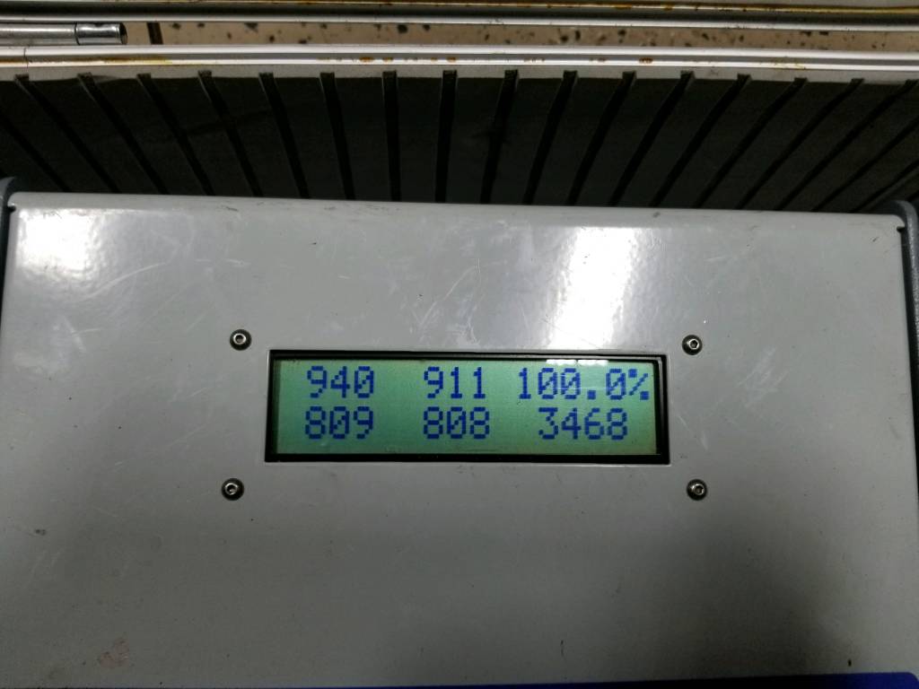

I have a question here on the rear coilover set up?? Is it normal to have to adjust 1 side more then the other to get the stance aligned? I have to give the car about a additional 20 full turns on passenger more then the driver side to get the car to sit even on the rear??
I had to do the same on mine. Guess after 30 years of abuse, who knows what you're gonna find with these flimsy frames
My drivers front is preloaded more than my passenger front. However I do have 30 more pounds on that corner
