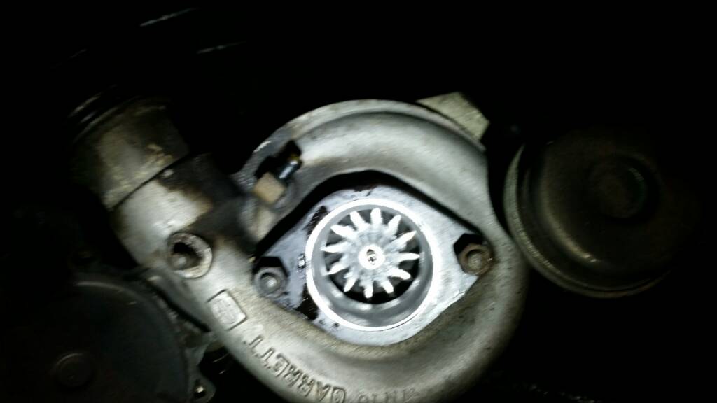

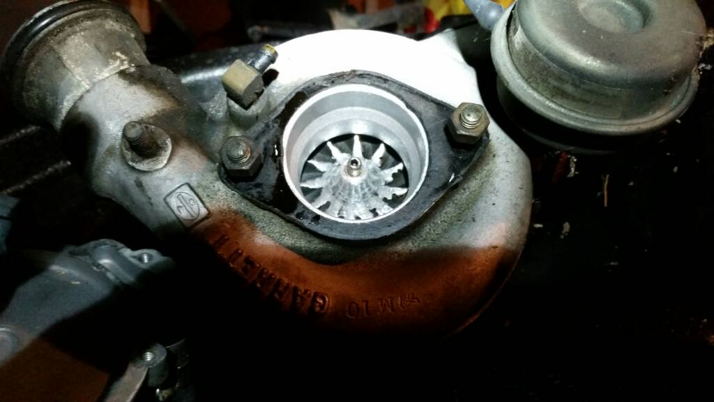

So I disconnected the tb from the turbo to prep for the ta33c that's going in. I knew the turbo was blown, hence the reason I am doing this mild upgrade. But DAMN! I need to drop the pan and check for pieces. Wow.
How'd it do that?
Sent from my LG-H740 using Tapatalk
Hell if I know. I'm the third owner. It had a major oil leak when I got it. The prior owner had just had the timing chain replaced and the hack mechanic used the wrong length bolt in the oil pump to timing cover. Anyways I kept the oil topped off, and gathered what I needed to repair, and then one day BIG cloud of white smoke. Tested, no smoke from the o2 port, so tell tale sign of blown turbo. She's getting a nice replacement though. And a full refresh, any further and I'd be doing a full rebuild.
Sent from my SAMSUNG-SM-G870A using Tapatalk
Looks like something got in there
Yea I know. But there is so much play in the shaft side to side and in and out I wouldn't be surprised if it shaved itself. I have to drop the pan and pray I don't see a bloody metal mess.

Worried, not in my opinion. However I would pull the intake and do a damn good cleaning and see what you find

Intake and heads are off. Everything looks good. Same hack did a half ass on the oil pan gasket, cutting the old one and then just silicone where it meets the timing cover so that's dropping today. I will update what I find.

Yea the pistons, valves, pushrods, lifters are all a ok. I am not too terribly worried. If I had more money I would pull the engine, tank it, etc. Just not in the budget. As it is the little things are adding up, like 30 year old tubing, tools I didn't have, lots and lots of brake clean lol.

Yup, out the tail pipe

So in the pics you can see there doesn't seem to be any visible damage. I haven't gotten under her to drop the pan yet, not a job I'm looking forward to. I believe I dodged the bullet but we shall see. Thanks for all your help and support on the board guys.

Nope. Bone stock. It's pretty much been determined the input shaft nut came loose and grenaded the turbo.

Have you found that nut yet ?
